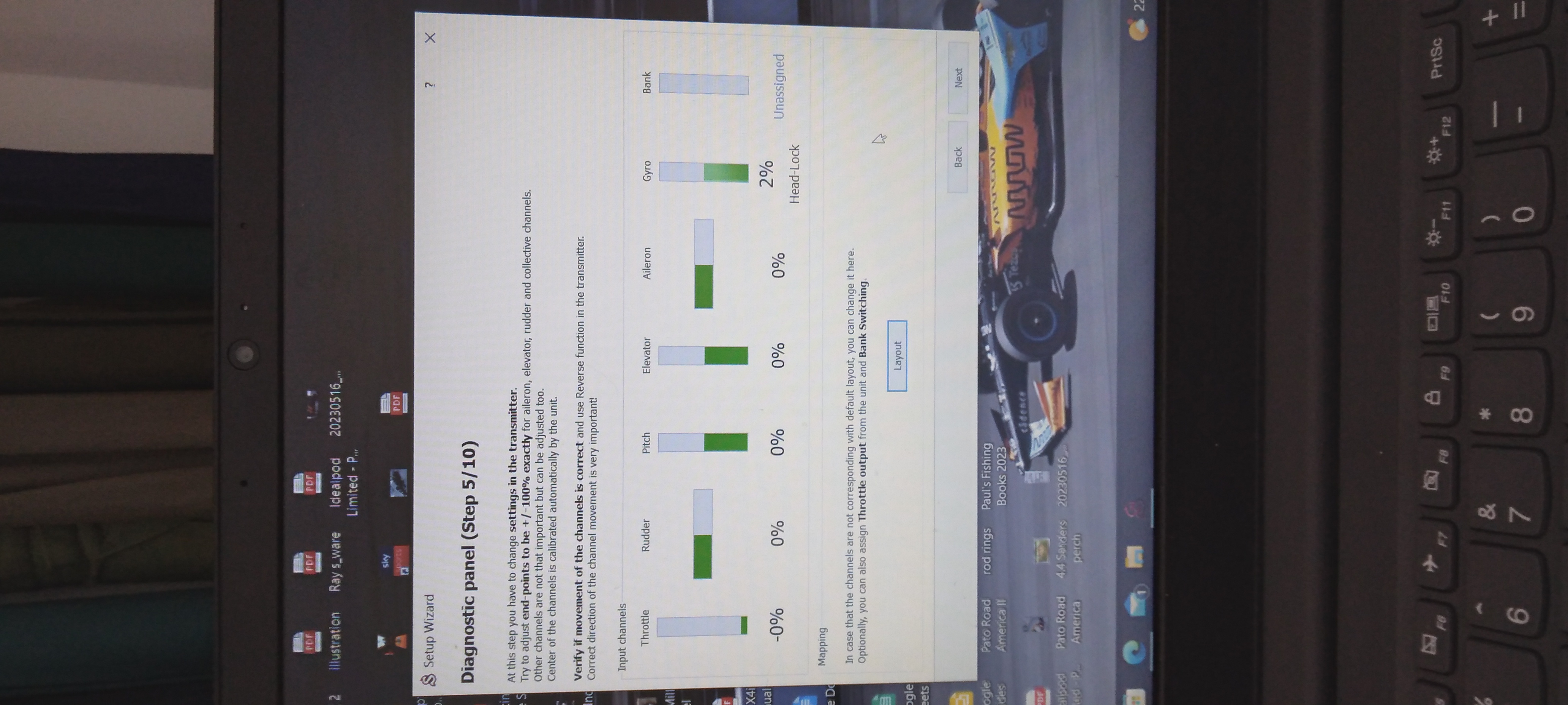

I have had my Spirit GT on my Gaui x4ii flying for over a year without any issues at all, in fact it is superb.
I recently used it to bind a separate DMSX satellite for another heli, but did it by mistake when in the Gaui model on my TX.
I then re-bound my spectrum SRXL satellites for the Gaui, but although shown as bound, the head does it start up dance, but after that I have no controls apart from the gyro when I move the heli manually.
My NX8 monitor shows I have movement on all the controls in the right place.
I have connected to the sprit interface set up wizard, and this is the screen in the photo which shows no movement.
Any help please?

All sorted, it was as simple as updating the FBL firmware to the latest, phew ;)
