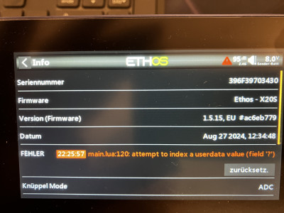

Hi, I downloaded the latest Spirit LUA script version for my FrSky X20S yesterday (23.10.2024) for FrSky integration. The script bug still exists and has not been changed to the new Spirit version that an LUA error is coming up after pressing the save button in the macro. The changed values will be saved in the Spirit but the error need to be deleted in the transmitter afterwards. Screenshot is some month old, but still valid. Please can you fix this? Best Regards Bernhard

Thanks a lot! Good to know that there is a big discussion about ETHOS integration topics in general. I didn't recognised that this bug was discussed in the FrSky Ethos integration discussion. I just opened it now because I expected that it has ben solved with 3.7.1 update, but it didn't.

Last version of ETHOS is 1.15.18 ... but coming soon 1.16.0

Just having 1.15.18 on my remote. Do I understand the post correctly? Is this a bug in Ethos solved then with 1.16.0 and not a bug in the Spirit Lua script?

No, it is that the LUA script for Ethos has to be modified, but it keeps going round and round, with the next update Ethos will change something and LUA will not work correctly again.
