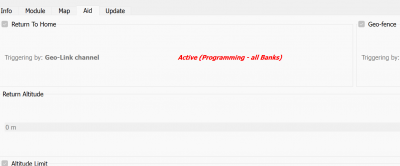

Hi, i must say RTH and Geolink other features always saves the day ! I have 2 bank configured with RTH and Geofence for 2 sites i use it the most. I want to use bank 2 to configure a RTH when i just drop in a site i don't fly often. I like the feature to enable configure of the RTH by bank and did change my settings in the radio to support this new feature.

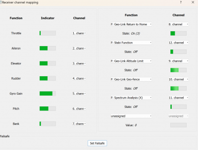

However, theyre is a difference when i configure this percentage setting in the geolink VS the servo windows.

When i programmed my radio Spektrum IX12 using SRXL2 i was not not seing the right message in the Geolink windows it is writing Active (programing all banks). When i change to the servo window it says On (3).
Theyre should be the message (affect only one bank) in the Geolonk window it seems like a bug and could affect users using that feature with geolink window to validate.
I tried it on a site and the servo windows for On(3) has the correct reading.

I am adding two screen snaps to the message servo window and the geolink window.
