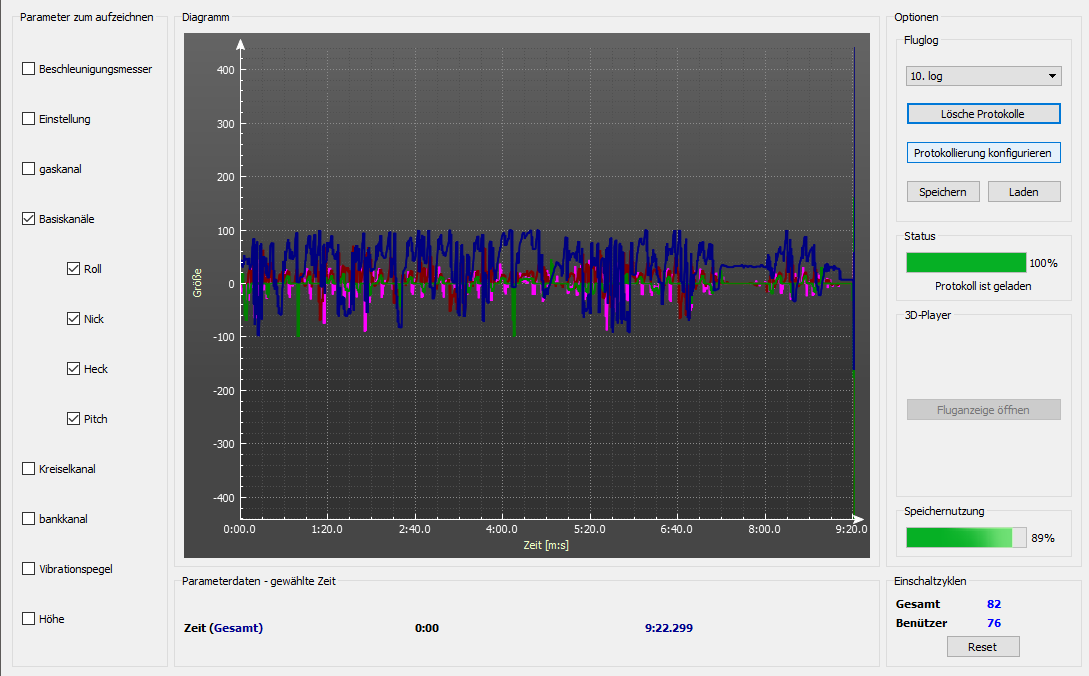

I'm using the Advanced Flight Viewer frequently and I very often run into the issue that at the end of the flight the values are very very high. Since the scale is calibrated to the peak values the graphs during flight are becoming so smal that they are hardly useably for analysis.
It would be helpful if the flight logs could be trimmed so that such "fales/unwanted" peak values can be ignored and the flight log becomes meaningful again. Or if the scaling could be modified manually - or both.
Bernd

I have the same problem, always at the end of the flight I have a massive deflection that pulls the scaling of the diagram upwards. This makes the values difficult or impossible to evaluate.

The issue was fixed in the upcoming Spirit Settings. Thank you for the report.
