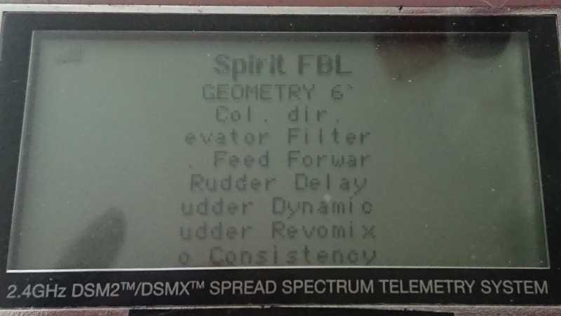

On my spektrum dx10t the screen layout is strange: menu texts are cropped on the left.
For a short period the left side of the menu is displayed and then the text slowly scrolls to the right, which crops the begining (i.e left side) of the lines. Shorter text menu would be better.
See attached screenshot.

This would be more an issue on Spektrum than Spirit I would think?
All that screen real estate and unable to display all the characters looks like some software on the radio that forces that to happen.

Not sure : the lines are too long, so they are scrolling from right to left. So technically the software does handles these long lines. When the scroll stops, I end-up with this cropped display which is a bit annoying.
It's very true however that it's a pity the airware software does not use the whole Dx10t screen size, but this radio is a bit of a niche market so they do not custom make a complete soft and re-use what works on other radios. They are still updating the software though.

the lines are limited unfortunately by telemetry protocol. The standard was designed years ago to make it work with the cheapest Spektrum radios.
We hope it will be improved, sadly we can't make it better.
Only the scrolling behavior can be changed.
