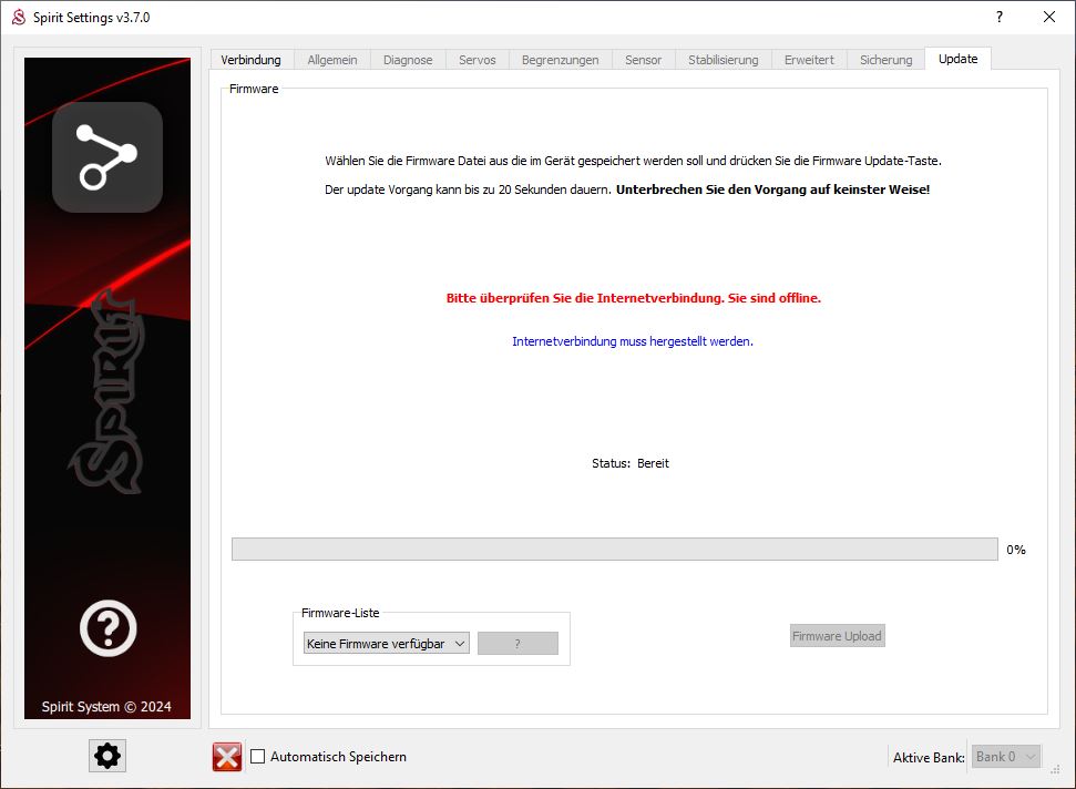

I want to update an older Spirit from 2.6.1 to the current firmware 3.7.0 and unfortunately I always get the error message that the server is offline. I also tried a Windows notebook - same result. I was able to update my second silver Spirit from 2.6.1 to 3.7.0 a few weeks ago without any problems.

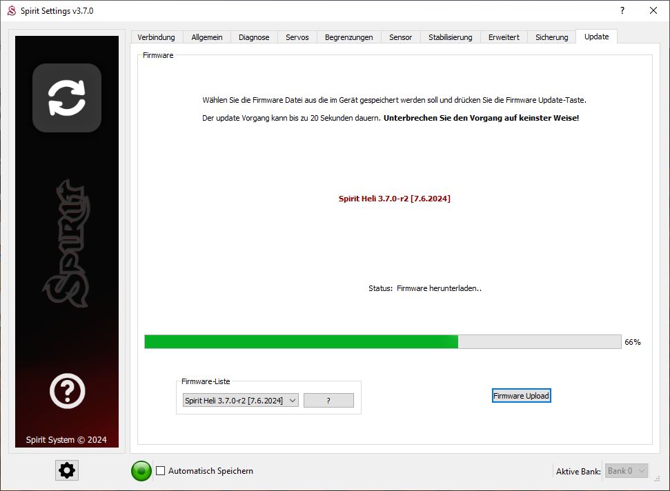

I tried to update again a few times today under MacOS and Windows Home 22H2 (got my hands on an old Windows notebook) without success. Tried it via mobile phone wifi as suggested and my home network too.
My Mac is a M2 with Ventura 13.6.7 and the last updates are a time ago.
To summarize:
This one special Spirit unit always gets the server error. I did a reset to factory default, reboot - multiple times. That didn't work either.
My second Spirit unit can connect and the update a few weeks ago was successful. The connection with this unit also worked today, there is no error message. There is also no error message in demo mode with software 3.7.0. I'm nearly sure there is nothing wrong with my internet connection and your server.
I can't see any difference between my two Spirit units, just that one of them gets no connection.
