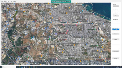

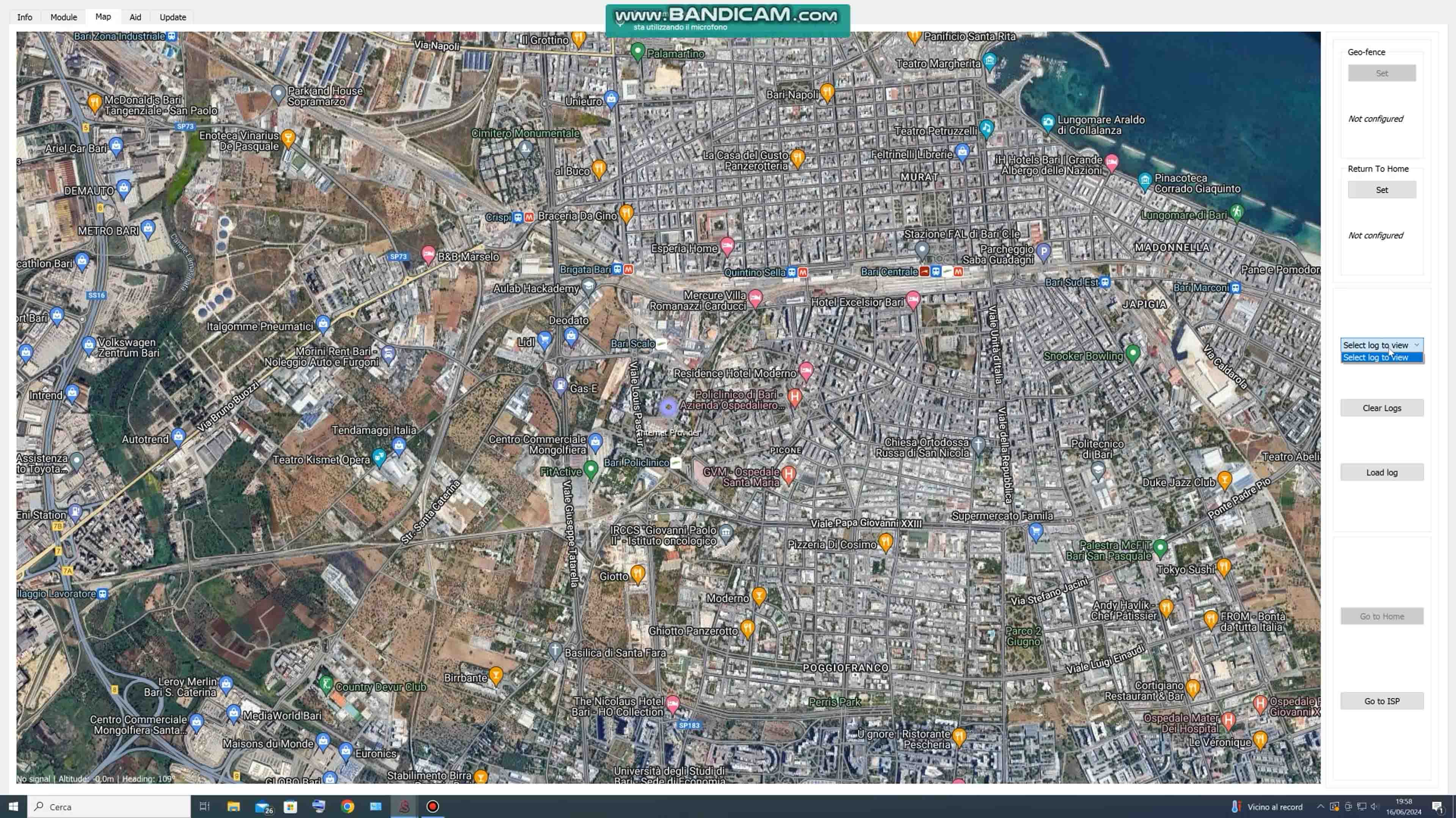

ZeXx86 wrote:
franz88: the logs are not recorded if logging is turned off. It could stop logging because there is Log Enable parameter.
The logs in the GeoLink are limited by memory. If memory is full it will not record the logs anymore.
Older firmware version had a problem that corrupted the logs occassionally. But with more recent 1.4+ it should be all ok. But first you have to clear the logs.
yes you are right I checked now and I have not enabled log geolink.
Because I don't use them anymore Since I've been using spirit gt and spirit gtr.
I had this problem with spirit rs but a few years ago.
Sincerely the gt and gtr logs they are much better.
But I can try next time I try the helicopter (in this heat I won't go out) I can enable geolink logs and see if it registers.
The log geolink I deleted them now I have empty geolink memory.
PS
on the geolink screen I don't see the close icon etc i close screen with alt + f4
