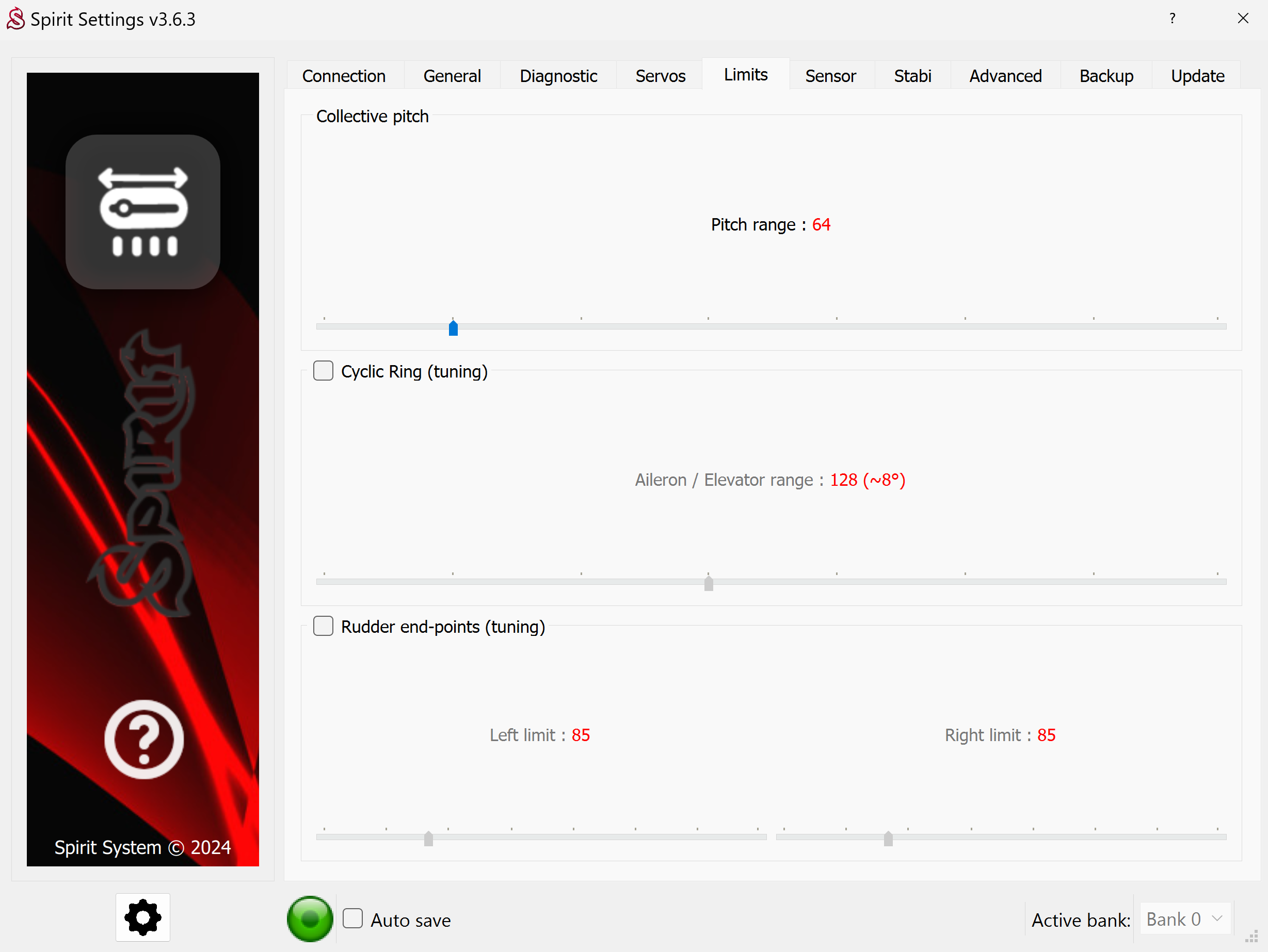

PostPosted: Sun 26. May 2024 19:37:54
Offline
Posts: 588
Hello Jabba,
I have mode 2 and for me its only the left stick which controlls the pitch, the right stick is Aileron and Elevator - The Rudder is on the left stick -
All settings have to be made only in the Spirit Software -
Your first question:
only the left stick in Mode2 (in my case) at midstick 0°
Your second question:
collective will be set also only in the Spirit Software Tab "Limits"
Your third question:
In the Diagnose Tab all the directions has to be correct for example if you give rudder left (transmitter) you have to see the same direction in the Diagnose Tab and it has to be 100 % -
This applies to all stick movements, that's very important !
I don't know the Jeti transmitter, so I can not say how you get 100% if you have only for examlpe 95% you have to change the sevo-travel - if direction is wrong you must reverse the channel in the radio -
If you have in the Diagnose Tab the right directions and all sticks are at maximum +-100% in then the most things are allright -
This is the only place where you must eventually change throws or reverse an channel in your radio !
After this point it is forbidden to change anything in the transmitter - changes are then only made in the Spirit Software nowhere else !
https://manual.spirit-system.com/index.php?title=SpiritRS
Diagnose Tab:
Limits Tab:
Matthias
