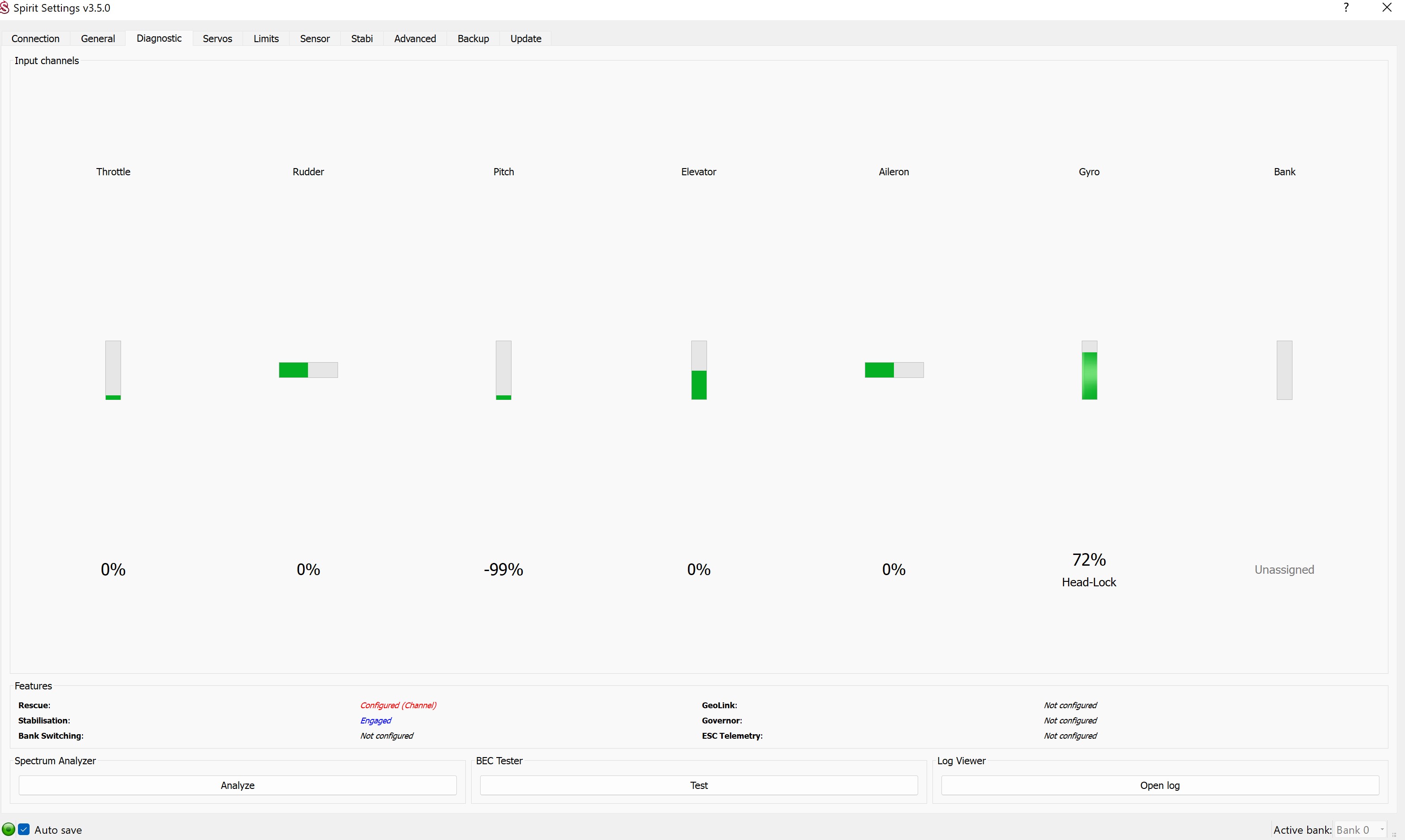

Hi No logs for the vibration, as I was not really checking the vibrations on the last flight.
I will try to make a test on the bech for vibrations, as this heli has a speed fuselage, but I never had issues like this.
Following ZeXx86's advice for other pilots, I enabled Extended Signal Processing after discovering via forum reading that other people have experienced similar problems.
viewtopic.php?f=20&t=5786
I do not know the difference between the two settings for the best performance on this page:
https://manual.spirit-system.com/index. ... ise_Rescue
There are two parameters that can greatly improve the reliability and precision of the stabilisation andrescue modes:
Stabi Correction and Extended Signal Processing
Both can be found in Advanced-Expert Settings.
While making some tests, I noticed that on the bench, if I activate the stabi, the heli will tild just a little bit to the right.
Theo

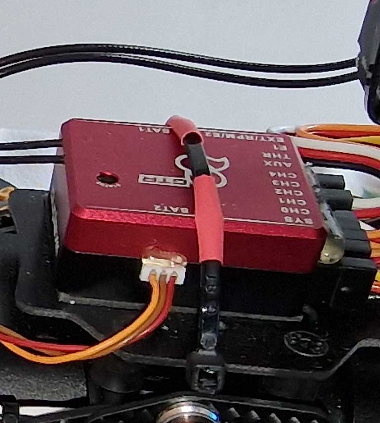

to reduce vibrations on my trex it worked well changhe the dumper rubber and the double-sided tape under the control unit.
also the electrical clamp with heat shrinkable sheath which maintains the spirit decreased my vibrations by 50%.
I have a photo of the goblin but I also have on trex
Nice one thanks.
Will replace the old original double side tape and test your method.
Theo

I do not recommend using a cable tie. I also highly recommend using original double sided tape - only one layer.
Please use Spectrum Analysis tool in the software. This will help you to find if there is vibration problem or not.
It is best to measure with tail blades on, because problem is usually in the tail mechanics.
