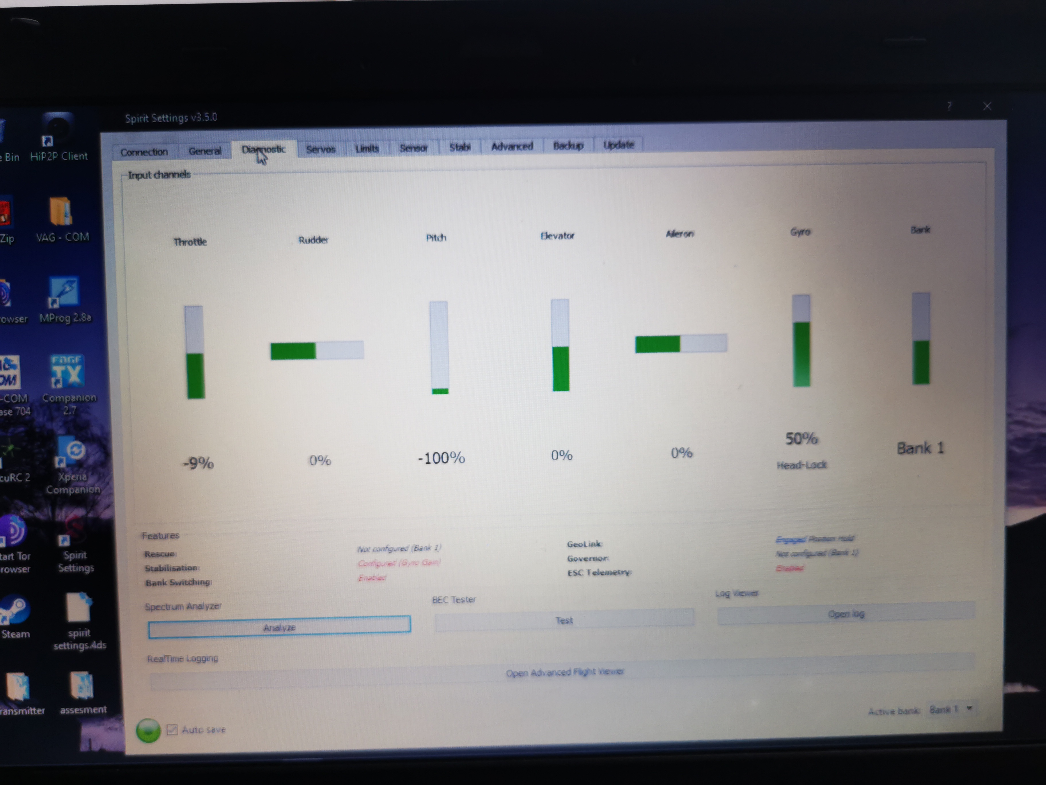

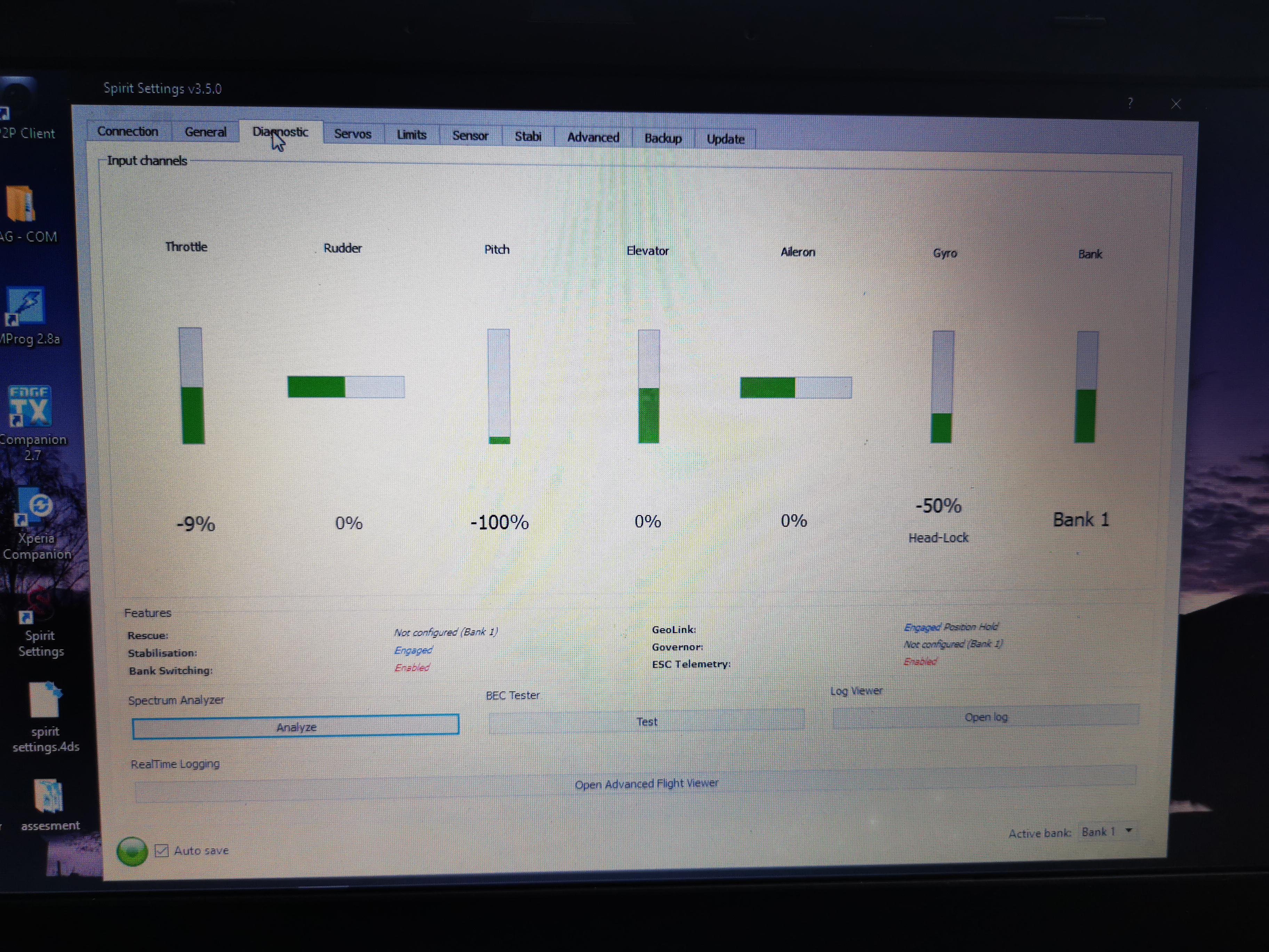

I have stabilization normal on bank 0 on a 3.pos switch so
bank.0 stabilization normal
bank.1 stabilization normal & position hold
Bank.2 rescue Automatic on channel & return to home. When i press panic switch it overrides to bank 2 and activates rescue function. If i switch into bank.2 return to home will function.
Everything looks good in diagnosing tab i had a small hover in bank.1 and 2 but while adjusting gyro found it acting a bit like flybared.
Went into diagnostic tab after to find gyro positive says seems to switch stabilization to configured(gyro gain)
