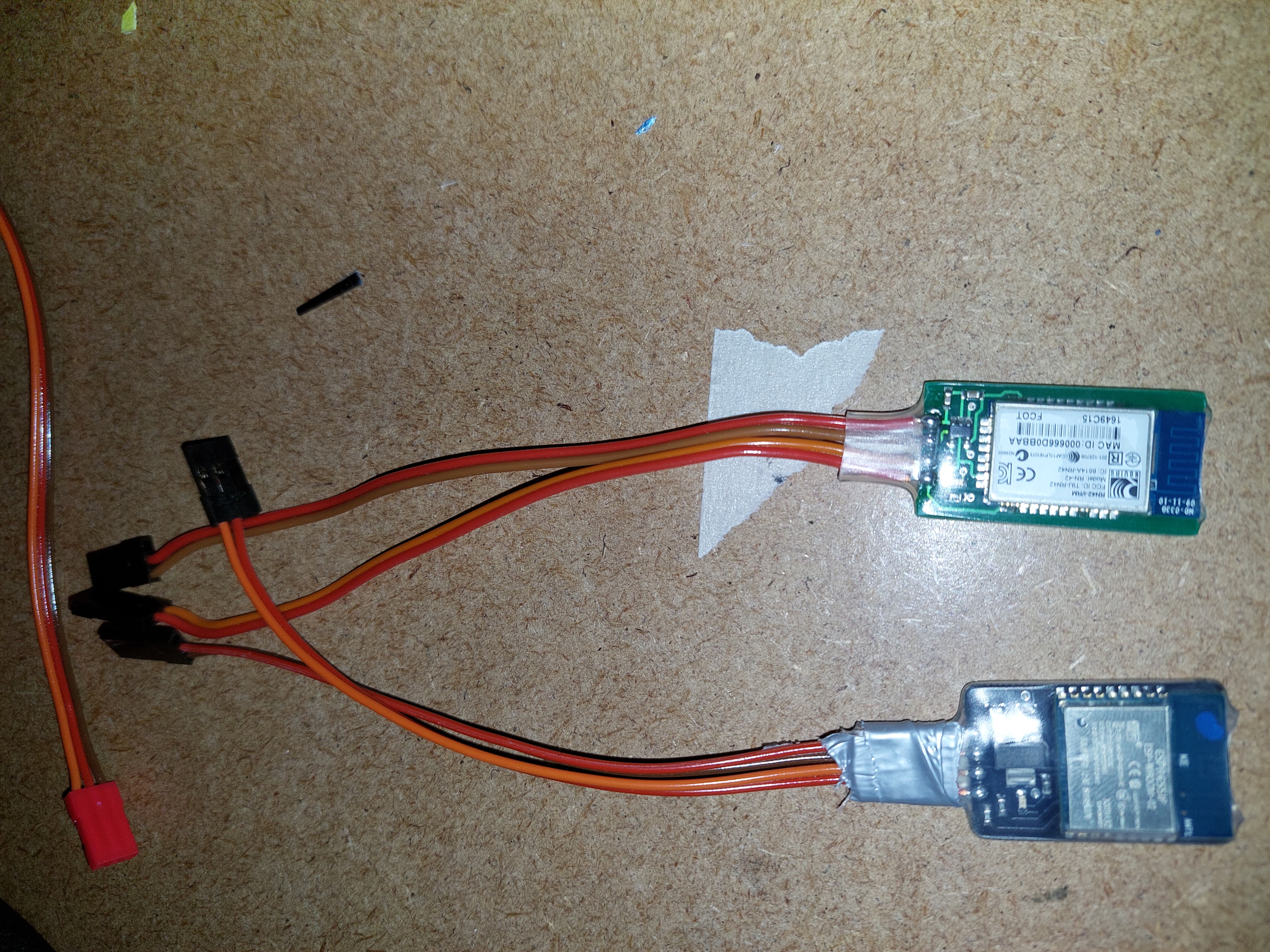

Hello! Excuse me for joining this thread, but I have a similar problem. I own two rather old and long unused Wifi-Links which I want to use now in my 450er and 250er. When I plug them in, (Sys and Aux2) they blink blue, but even don´t appear in the wifi-list on my computer or my cellphone.
Maybe they are too old and have to be flashed,too.
Thx for a reply! Regards, Susita

Hello! Thx for the reply and little Update:
I managed to flash the wifi-link and to install the update. Further problem is, that only managed once to get into the settings for a short time. Seems that the link shuts down it´s connection, when I try to enter the client in my browser on pc (no blue led anymore then)
For my android-cellphone: Link shows up in wifi-list, but shuts down while trying to connect.
I kindly ask for further help on this problems.
...I just figured out, that the "smaller link" seems to be a bluetooth-link? I couldn´t try it yet, but is there a need for upgrading, too?
Thx and Regards Susita

Posted: Tue 15. Mar 2022 15:24:59 |
Site Admin |
Joined: Mon 29. Apr 2013 16:06:44 Posts: 12387
probably you configured Wifi-Link Auto Turn-Off. This will shutdown the module if there is no connection.
It is enough to disable it back. With default settings it should just work.
Yes, each module has label at the PCB so you can find what it is. No need to updated Bluetooth module.
