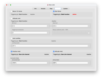

When Geolink picks up the satellites and I activate the stabi (coaxial) function, the cyclic plateau leans forward. If I turn Geolink off and turn on stabi the cyclic does not move. What's the problem?
Should the compass be recalibrated? I checked the compass and it says 90 degrees in the middle of the north.
PostPosted: Mon 07. Feb 2022 21:22:50
Posts: 12501
probably you have enabled also some other GeoLink function.
For example Return to Home. Please set see Diagnostic tab. Then disable GeoLink function that is enabled.
PostPosted: Mon 07. Feb 2022 21:40:02
Joined: Mon 07. Feb 2022 20:59:00
Posts: 15
No, no, no other features enabled. I have Position Hold + inter and Altitude Hold + inter. Stabi + inter. When Geolink captures the satellites and I only activate Stabi (coaxial) the cyclic gives roll. If I disable Geolink stabi works well. :evil: :twisted: :twisted:
PostPosted: Mon 07. Feb 2022 21:43:11
Posts: 12501
This will exactly happen if a GeoLink function is also enabled.
I am sure it is as I wrote.
Please disable GeoLink function in the Aid tab of the GeoLink window. Then all will work fine.
PostPosted: Mon 07. Feb 2022 22:33:11
Posts: 15
I disabled all functions in Geolink in the AID tab. When Geolink picks up the satellites and I activate Stabi the cyclic tilts towards the ailerons. No Geolink function is enabled. When the blue diodes light up on Geolink the stabi function gives aileron when activated. As long as the blue diodes are not turned on, stabi works properly.
PostPosted: Mon 07. Feb 2022 22:34:45
Posts: 12501
Thank you. Could you please share your settings file?
PostPosted: Mon 07. Feb 2022 22:46:54
Posts: 15
I'm doing that tomorrow.
Good night.
PostPosted: Tue 08. Feb 2022 10:03:21
Posts: 15
Here's the settings file as promised last night.
I hope it's the right file or you have to tell me where to find it!!
Sauv1.4ds [255 Bytes]
Downloaded 44 times
PostPosted: Tue 08. Feb 2022 12:03:17
seem you have geo-fence enabled on the same channel as stabi
PostPosted: Tue 08. Feb 2022 12:08:46
Posts: 12501
Indeed, it is like I said. Please turn off GeoLink function and then everything will work.
In this case disabling Geo-fence will make it work. Or if you will assign it to other channel than Stabi function.
