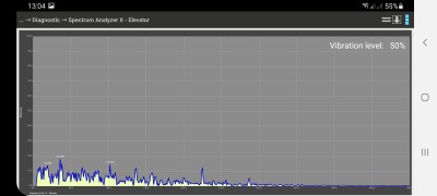

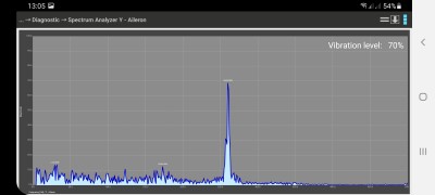

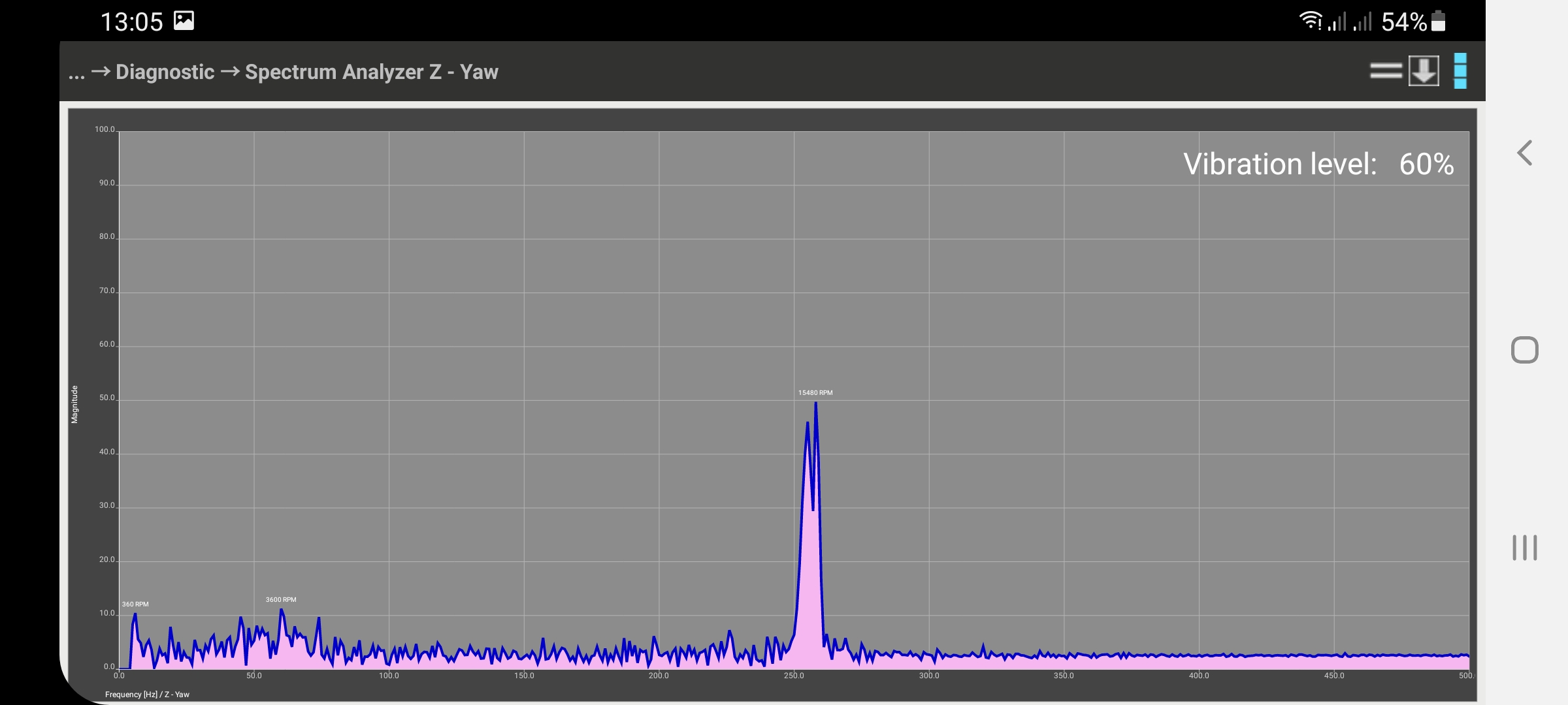

Hi I have just install a spirit 2 fbl system on my 700 nitro. I follow the setup wizard without any special difficulty.
Before to try the first fly i decided to make a vibration analysis test. After i remove tail and main blades i follow the procedure of testing and when i spool up the rotor head speed to the value i usually fly i mention that the swash plate was very little shaking. Is that normal? Thanks

From Vibration analysis it is easy to locate and find the problem. So if you can provide me a vibration plot I can help.
 Post subject: Re: TREX 700 NITRO
PostPosted: Tue 04. Jan 2022 13:40:03
Joined: Mon 03. Jan 2022 18:08:45
Posts: 59
Hi. I will try to post the vibes analysis.
File comment: 3
File comment: 2
File comment: 1
PostPosted: Tue 04. Jan 2022 13:41:32
Posts: 59
This is with tail blades on. Thanks. Please let me know
