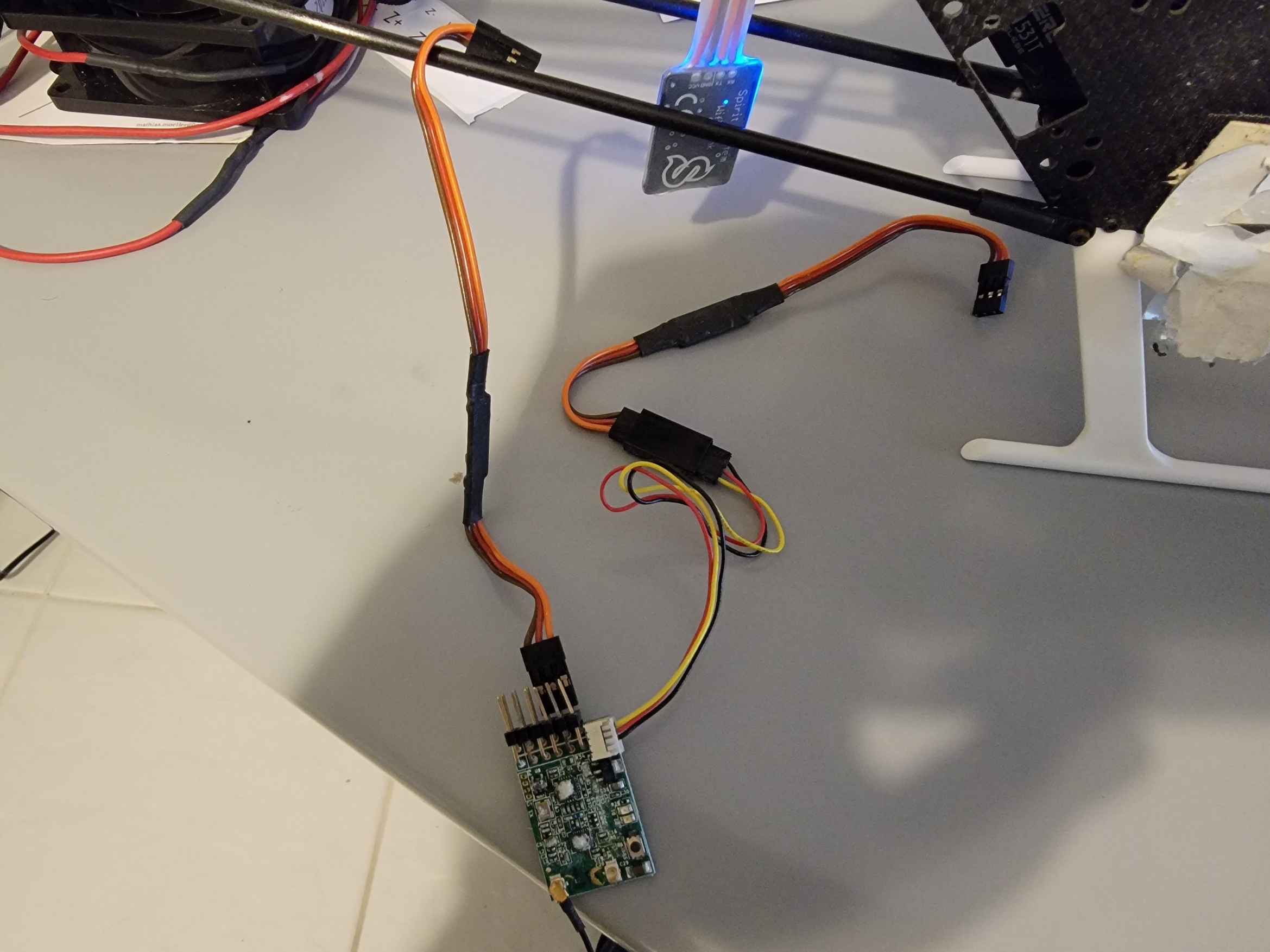

However, I have from my receiver those to sort of special cables. Does anyone know what they are?

Cable that is coming from servo port is SBUS adapter.
Other cable that is coming from S.PORT is FrSky integration cable. So the receiver is from FrSky.
