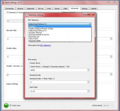

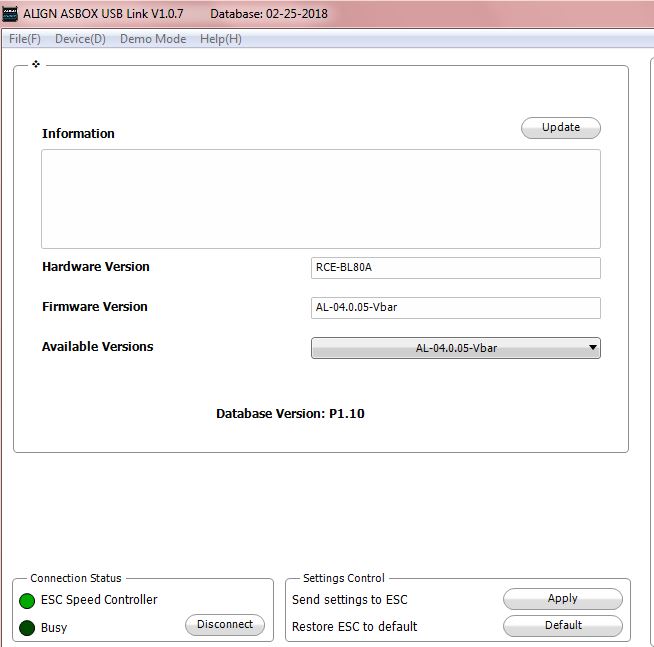

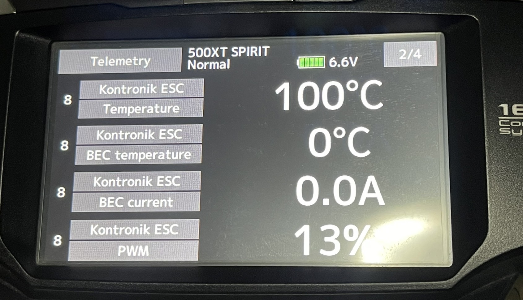

I have very similar problem and hope Mr.Tomas can suggest a solution.
My setup is Trex 500XT with Align RCE-BL80A ESC, Futaba 16SZ radio with R7008SB RX, FASSTest 18CH selected and Spirit Pro FC.
Throttle signal is with pull up 10kOh resistor, ESC RPM signal wire connected to Spirit Pro. RX connected to Spirit Pro vis S-Bus2.
I could only see RPM data via telemetry. After reading previous inputs of this post I had upgrade the ESC with available software update AL-04.0.05-Vbar. That was the highest available for RCE-BL80A. After that I selected the HOBBYWING Platinum V4 telemetry from Siprit SW which I thought was the closest to the Align. I got additional few data such as ESC PWM, ESC TEMP (shows 100C) and ESC A (sometimes shows 1.0Amp). My feeling is that the shown data is not a accurate accept the RPM.
Is it possible to have telemetry feature with the Align RCE-BL80A ESC and Spirit Pro combination? If yes, please guide me with the setup.
Thank you,
Amal

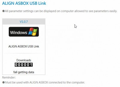

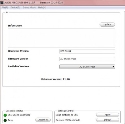

No, I didn't try to fly it yet. I am still in the assembly stage. My ESC is not HobbyWing. It's Align RCE-BL80A, the original ESC came with the 500XT.
The software update came from Align website. http://www.align.com.tw/download-en/asbox/. There is no other software available other than AL-04.0.05-Vbar for this ESC. Any thoughts?

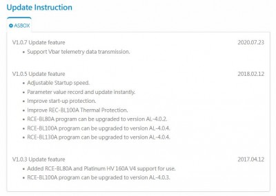

You will need to flash firmware that is not for VBar. Unfortunately HobbyWing made the firmware only to make telemetry working with VBar. But this update removed support for their telemetry. So it is really necessary to flash older firmware.
Same apply for Align ESCs that are rebranded HobbyWing ESCs.
