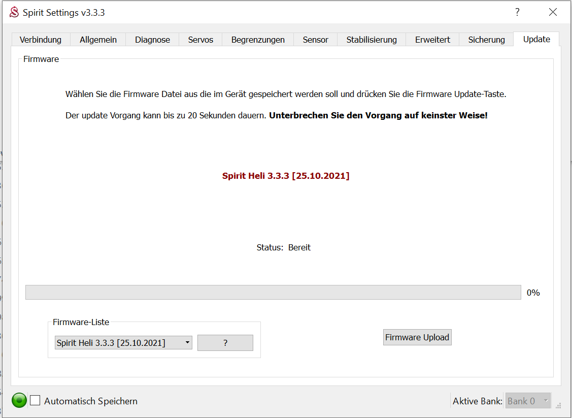

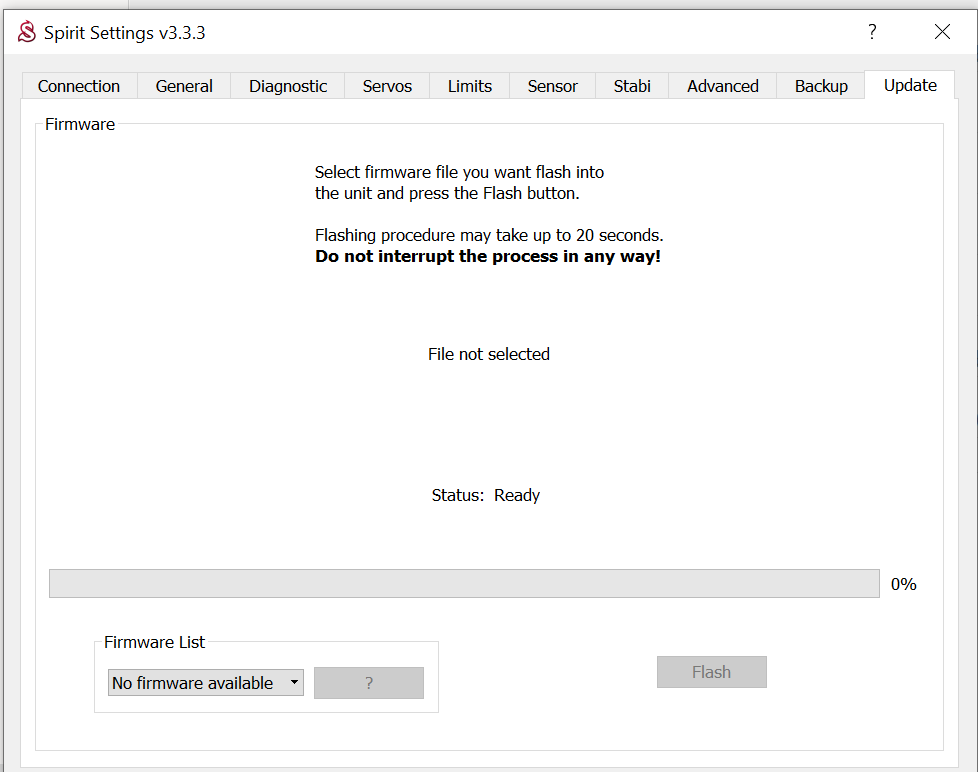

Try to update, but 3.3.3 Spirit Settings say no update available
Please help

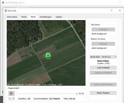

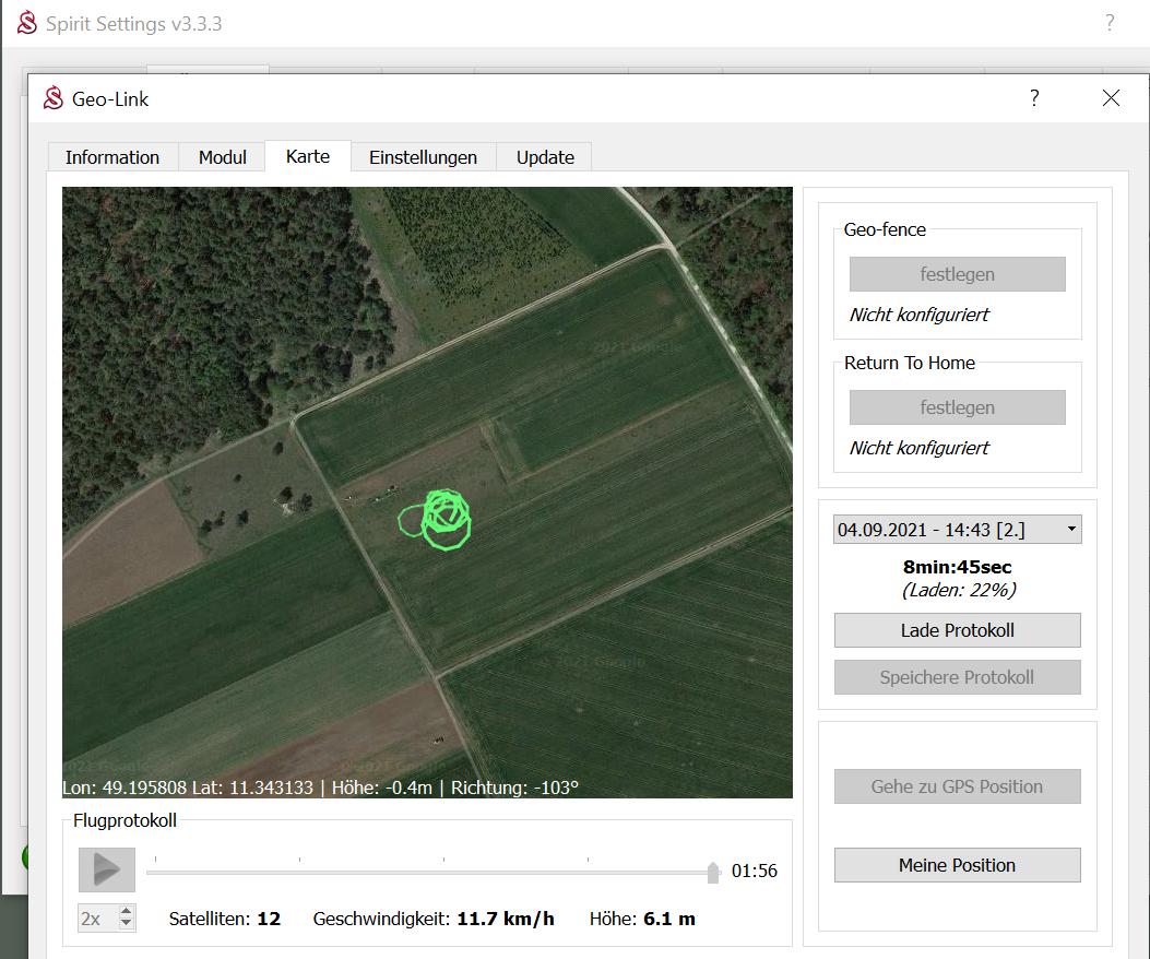

I can load maps over geolink
Thanks for your help

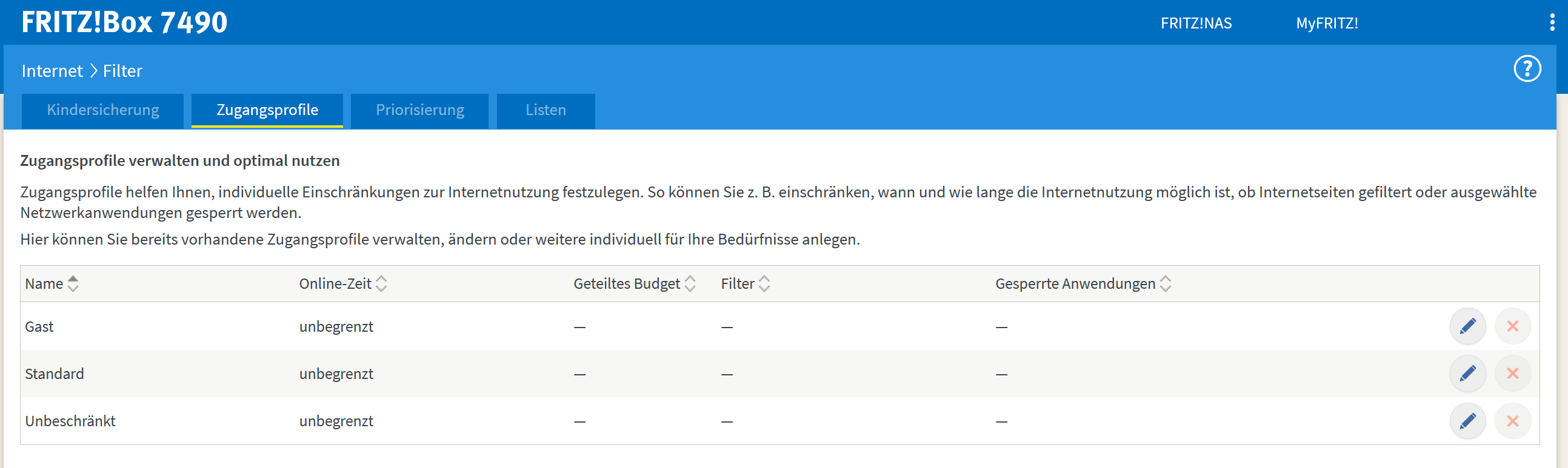

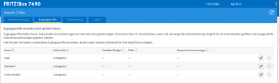

I have set all to unlimited in Fritzbox:
ripper is the PC with the settings software:

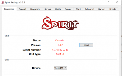

Can you take a screenshot of the Connection tab with Spirit Settings 3.3.3 please when unit is running?
