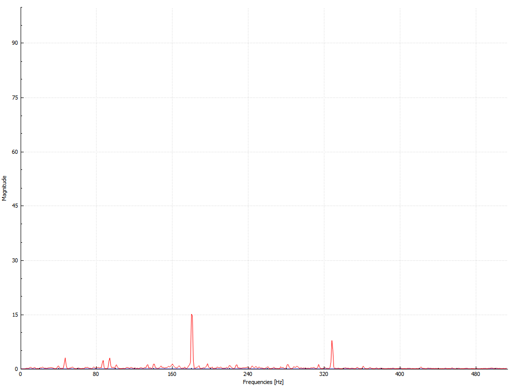

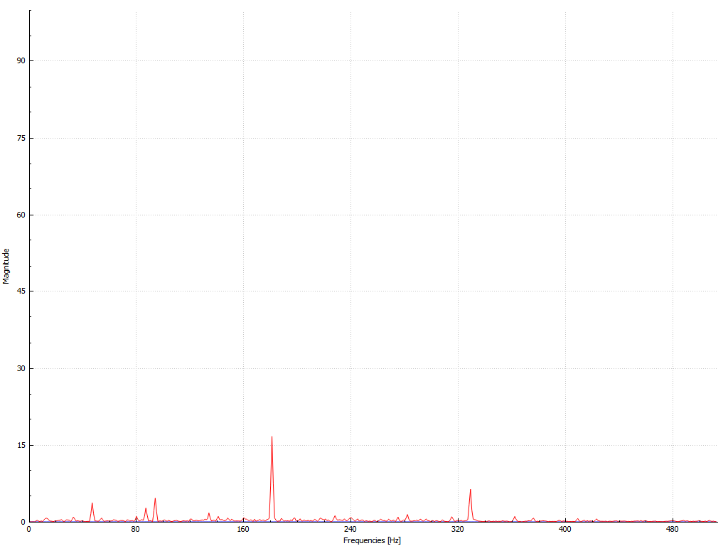

I have a 550L and I mounted it in the top location the same as I had my GPro mounted previously. The worst I see from the analyzer at full throttle with the canopy on is spike just above 160Hz at slightly above 15 on the magnitude scale and it's about the same with the canopy off. One thing I did do though was cut off the rubber coverings around the servo connector that allowed them to sit almost a 1/4 inch lower.

the biggest spike is coming from the rudder so cables shouldn't play any role in this. Altough it is quite small, so it is OK.
