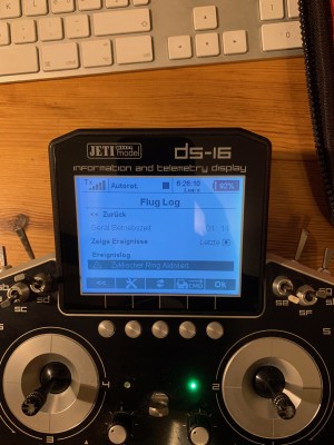

The log says „Cyclic Ring activated“ when it happens and after re-initialization the log is clean.

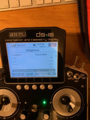

It look like some channel is not centered properly.
I believe you will see this also in the Diagnostic tab.
