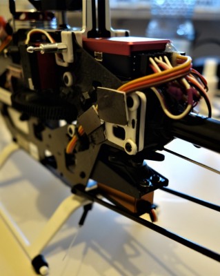

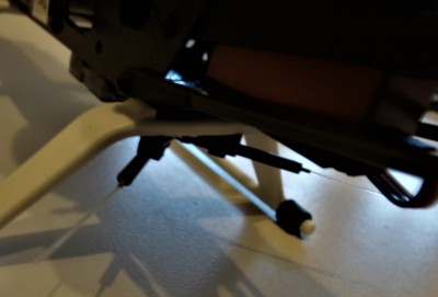

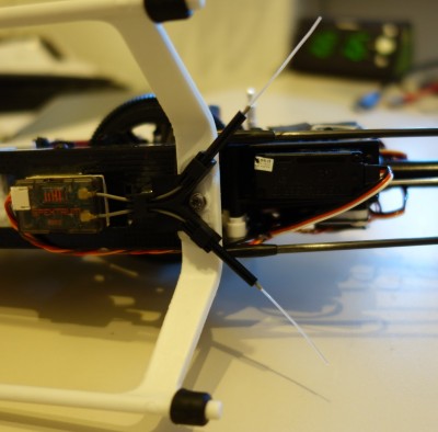

I put my helicopter on it and did a range test in all four directions (the helicopter rotated 4x90 °). The distance was about 28 m. In the transmitter I set the range test, held the bind button and read the displayed values. I always used the spark's Aileron and elevator levers. A friend registered whether everything was running smoothly - Everything went as it should - The following values were then obtained Antenna A: 6; F: 6, H: 0 - The lowest value of the received power was at -86 dBm or 21% R - To be honest, I don't find the result great. However, I'm not sure what that ultimately means for the range (how many meters), I don't know - what do you think about it ?

i have used the single 4651T on a Logo 400SE - so a bigger heli than your Rex 450... it's a 'real' 470/480. i had the Rx & antennas mounted very similar to yours, just a little bit higher (Logo 400 lower Gyro platform, ~ where your tail servo is). no problem with the Logos plastic frame.
i would not be worried... just try it in flight... do not fly to far first and check what happens during really slow piros or flips. log the antenna results for later check in detail and set alarms to be warned if frame losses are getting critical. then increase the distance and watch. it is clear - if you read the rcgroups post of Miguel Alvarez and other Spektrum developers - they clearly advise to use the 4651T plus additional Sat on anything 500+... and they personally would even use additional Sat on 400+ if i remember correctly. following that advice your setup should be safe... officially mine was not ;)

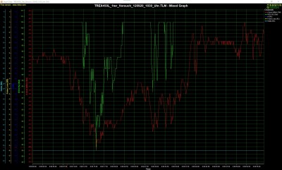

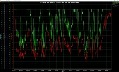

Today I have trusted me to make an "Range-Check" in the air with my TREX 450L with SpiritII and new configuration with SRXL2-Receiver SPM4651T...
In my DX18 Gen1 I have programmed warnigs for signal level at -61dBm and Framelosses greater than 20 -
With a little palpitation, I took off...and the tail of the helicopter was directed to me. I was about 5 m away than I got a warning of the signal level below -61dBm ! I was really surprised and landed immediately. I checked my radio but there was no Fade, no Frameloss and no Hold - I looked in the TLM-File and there I saw that the signal level was really under -61 dBm, but as discribed no frameloss and no hold.. In the flightlog I set the warning level of signal strength to -85 dBm and the framelosses as described greater than 20 -
Then I made an second flight also with a little palpitation - I got no warning about the signal level again - I made some pirouettes, fly farther away and higher also with pirouettes.
After, I did not know exactly, about 5 Min I landed without any warnings. After that I looked in the TLM-File and here are no Fades, no Framelosses and no Holds - The signal level swayed quite strong in numerical value (-dBm), look in the added files -
What I have learned from this is, that the signal level does not seem to play a major role, at least with Spektrum, since I have not seen any fades, frame losses or holds in my remote control or in the TLM file. I assume that as long as I have got none excessive framelosses my range is absolutely fine - what do you think about that conclusion ?

same conclusion i made... looks just like mine (above) did... i would have no problems to fly like this. i had set my frame loss warning to 10 iirc... never reached it with this setup. even on my bigger helis where i've used AR7700 + additional sat i've only once scratched the warning threshold - the sat in the front of a 700 died... it was flying with main receiver only.
