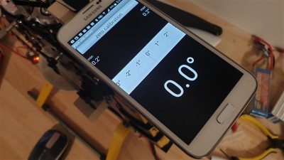

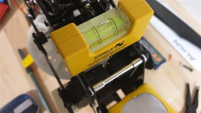

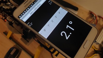

I started working on the Coaxial setup, but decided to check everything again before this. I did NOT like my findings:
1) My control rods - Ail / Pitch are both exacly 30mm in length between the plastic connectors
2) Swahplate is leveled
3) I am using one blade as refrence, set mid stick - have zero on a spirit level on the frame and on the blade. Also have zero on the pitch gauge app - the blade I am checking is to the front of the heli.
4) I turn the rotor around so that the 2nd blade is at the front. Pitch gauge shows +2.1 degrees
5) Both control horns to the DFC arms are same length. They are both screwed all the way IN, so I will have to unscrew the one I am using as Reference out - to make it also +2.1 degrees
6) Then, re-center the whole swashplate downwards to get Zero at mid stick.
Is my thinking correct?
How can the two DFC arms need to be so different in length?
For the initial checking the 6 degrees, should I check on the blade positioned over the tail or the one pointing forward?
Going mad...

Few assumptions here:
1) you still have sub-trim box checked so the Spirit is holding zero position
2) you have measured the level of the swashplate with a method like using a tie wrap
3) the “paddles you are using are flat and straight- looks like cut boards that you lay the phone on?
If all the above is true then you have a mechanical issue...
Check these things:
A) is your main shaft is bent?
B) the feathering shaft is bent?
C) never assume those plastic connectors are the same length actually always assume they are not. I don’t see how they are 2 degrees different though.
Seriously, if you have checked your servo arms are mechanically as close to 90, your swashplate is mechanically adjusted as close to 90 and then fine tuned with the settings in app then the issue is mechanical of nature or you are measuring wrong but I cannot tell from the pictures and never used a phone to the pitch.

It's why you always use a master blade. Do all setup on one blade and try to get the other as close as possible to the same pitch with the links. Later on when you are confident to you can observe the tracking of the blades in flight. Get an observer to look for you. Only adjust the NON master blade to match the master.

Hello my teachers,
I am responding here to all the 3 of you who took time to try and help me, thank you all for that.
1) My balsa blade replacement seem to be the problem, they are not perfectly the same.
2) I am always leveling the swash plate with the Align leveler tool. My 90 degree starting point was set during the FB old setup, I didn't touch it when I started my DFC / FBL conversion.
3) The main shaft is a genuine Align, new shaft. The feathering shaft is well fixed, can unscrew it, possible was done by Gartt with RED threadlock, but it is new, never flown... So, I will assume it is not bent.
4) The DFC FBL head is from Gartt, not much to add here. The swashplate that came with it is clearly loose and has a lateral play around the shaft. I ordered an Align Swashplate, it is stuck on its way from CA.
5) My current Pitch gauge is faulty, so I am using the mobile app, until my new pitch gauge arrives, not perfect I know.
6) After installing the main rotor blades, the "difference" between the two blades (measured at the front) is about 0.5 degree which I will correct with the DFC arm.
