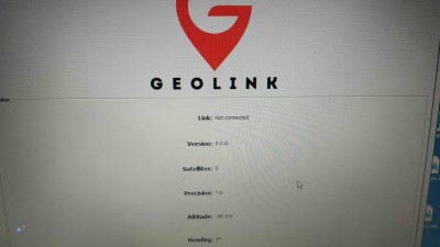

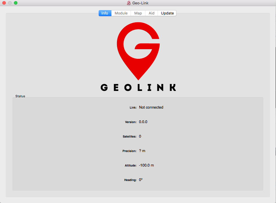

the blue light on geolink is on but the software says "not connected".
I have made the compass calibration for several minutes but...no way.
The only workin tabs on the GeoLink page are info and update.
I tried to update the firmware but unsuccessfully.
How can I solve?
Thank you for helping
PostPosted: Wed 15. Jan 2020 15:40:50
The only way to solve this problem is to finish the calibration.
It will not finish if done improperly. It is very important to rotate with the module in all possible directions.
If needed I can send you a video that is available on YouTube.

PostPosted: Wed 15. Jan 2020 19:16:09
GeoLink should blink when you are moving with it. As shown at the video.
Calibration mode must be first requested by clicking in the Spirit Settings. I thought you have did it.
If there is only one blink, then GeoLink is operating normally. And likely the problem is in connection. Please check if the cable is connected at the right port.
PostPosted: Wed 15. Jan 2020 19:48:57
Joined: Sun 29. Dec 2019 19:15:12
Posts: 12
Solved! I have connected the geolink to the sat 2 port and it’s working.
I was getting crazy, thank you for your patience.
I hope this post can help other customers.
Have a good night

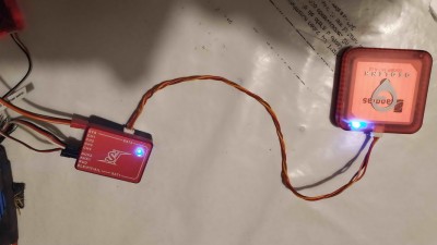

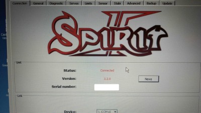

I "reopen" this post, because I have the same problem. "Geolink is not connected". Geolink connected to Sat2 Port. Blue light ON, Spirit 2 Fw:3.2.0 .
From flymax767 post:
"2.3 Calibration process
In order to perform the calibration it is necessary to enter Spirit Settings/GeoLink/Module and click the Calibration request button.
The problem is that I cannot enter Spirit Settings/GeoLink/Module as it says “not connected”! "
Best regards.
Jorge
Spain
