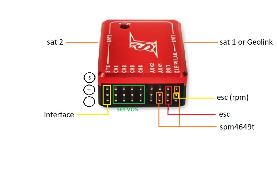

Hi
Can anyone help me further?
I ordered the Spirit 2 today.
Are the connections of the Empf. Spektrum 4649t the same with Spirit 2 as with the Spirit Pro?
black, red in Rudd.
and the orange cable in Ail.

The connections should be like that?
PostPosted: Fri 20. Dec 2019 10:59:30
Joined: Mon 02. Oct 2017 22:35:03
Posts: 81
Your drawing is incorrect !
ESC plugs into Aux 1 not the Rud port.

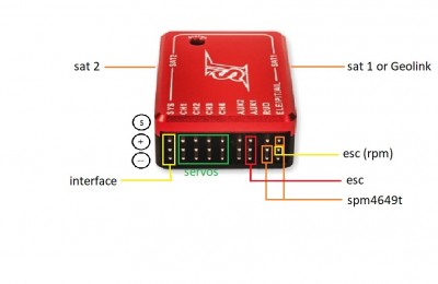

Correct, I was wrong to paint, so it would be correct.

Hi
thank you very much, see something clearer.
You can still display the spectrum integration
do not turn on my IX 12.
It works with the Spirit Pro and a SP4649T in the other helicopter.
Am I doing something wrong?
