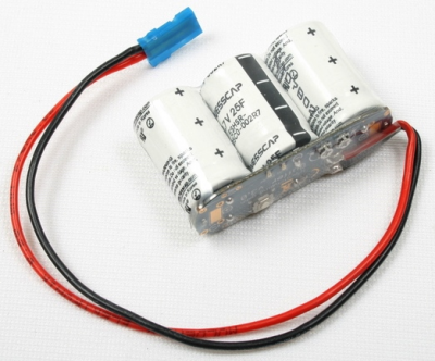

Hi I have these capacitors and I am fully satisfied
Logo 700,T-Rex 500X Dominator, Spirit PRO, GeoLink, Jeti DC-24
PostPosted: Thu 28. Nov 2019 9:58:27
R2 buffer is the Ferrari of the capacitors ;)

Yes they sure are, too bad no one sells them anymore, at least not that I could find.
