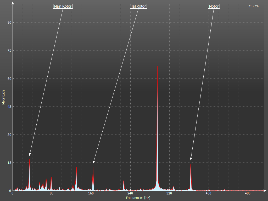

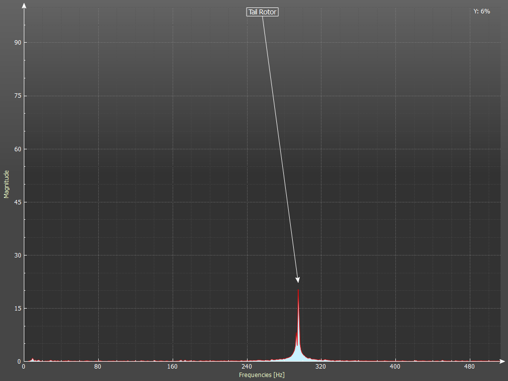

It's a Goblin Kraken with Spirit Pro. I got confused by high spike in aileron axis. But after some calculations it looks like it is the motor. I run 2050 RPM, with gearing ratio 8,7; this means 2050*8,7 = 17835 motor RPM, /60 = ~297 Hz which is where the spike is. Am I calculating right?
If so what to do - is this some faulty motor, or do I just need more foam below the Spirit? Like two of them?
The motor is Kontronik Pyro 800-48.
Update: forgot to say. The analysis is done on the bench without blades.

Also, what could be the spike with higher freq, which Spirit marks as "Motor"?

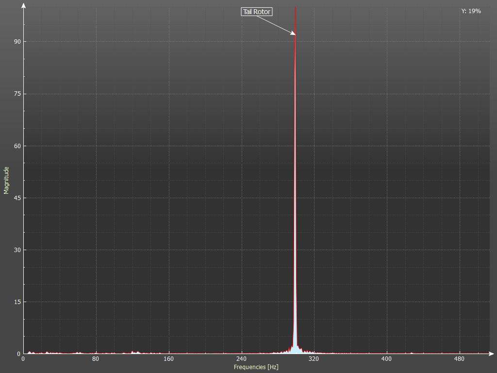

What I've done is:
- removed motor belt
- dismounted motor pinion
- made sure the engine mount screws are tight
so now it is only the engine with naked shaft spinning. And just by touching the boom I feel huge vibrations. I can't see anything (like a bent shaft) but touching anything makes it clear. Also, Spirit shows this:
So it is indeed the engine...
I think this is not normal, or is it? Is this a faulty engine?

the motor might be simply unbalanced or damaged. It might be undetectable by naked eye. The spike shouldn't be that high for sure.
You might check the bearings carefully. Some bearings can crack if you will insert shaft, gently push radially and rotate.
It's a new Kontronik I just bought for this heli, so I don't want to open it. I've send an email to the supplier and we'll see. Thanks for helping.

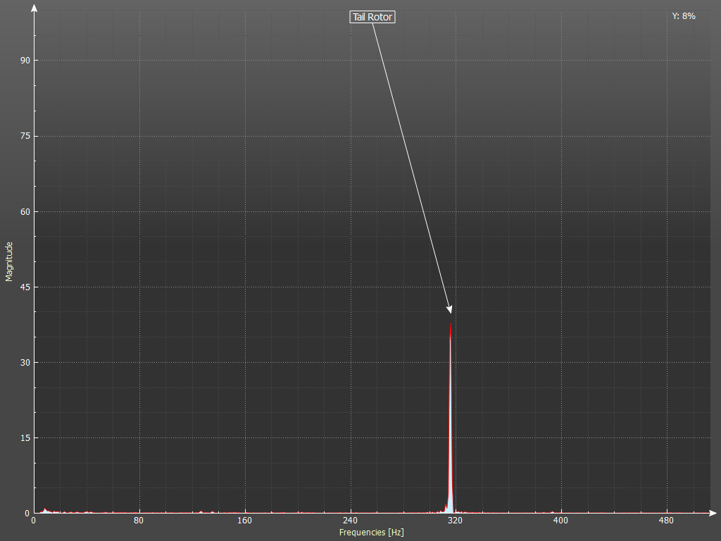

Hi Thomas
I got the motor back from supplier after repair. I again made vibration analysis. It is done on the bench, and only motor is spinning. It has no pinion mounted. It looks much better now.
At low RPM (I think I have something like 1950 configured) vibrations are not visible on the graph at all. On higher RPMs they do show up. They are much lower then before. Can you please tell me if this level is normal or acceptable?
PostPosted: Fri 25. Oct 2019 12:38:07
yes, this level is normal.
Some motors are producing lower vibrations but this is already good.
