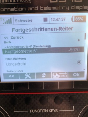

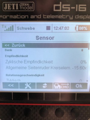

Hello!
What's up with my spirits?
Today I wanted to fly with two heli's in nice weather.
- TDF: REX3, SpiritPro
- TDRII: REX7, SpiritPro
Both Jeti DS16 (V. 4.28)
A few adjustments on the airfield I wanted to correct locally!
So in my Jeti DS16 in the SpiritFBL settings chosen to change something.
Inexplicably, I find utopian values here, see photos ...
If I want to make changes, change pitch servo or roll servo, only the tail servo moves ... ???
At the PC in the Spirit Software, everyone is the same, everything is correct!
Is it on the DS16?
What is going on?
Are there similar "incidents" from you?
greeting

The only thing you have to do is to have updated Spirit.bin file, especially if you have performed any update of the JETI radio it was overwritten.
You have not specified what firmware you are running so it is hard to help more. But it should be all updated.

OK!
It's just strange, since I have not done updates or updates for weeks ...!?
But will make an update now!

Done!
PostPosted: Mon 25. Feb 2019 15:42:23
And what is result? :)
PostPosted: Mon 25. Feb 2019 15:52:09
Joined: Tue 30. Dec 2014 7:50:36
Posts: 135
All data are identical as in Pc.
The DS16 shows again "normal" data !!!
