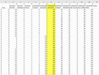

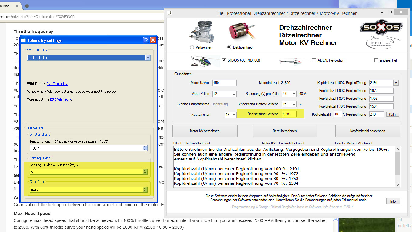

Actually I cannot use the setup software (see another post). Is it available in WLAN HTML as well? I set it there in the governor config (enabled it and disabled it then) but the RPM shown in telemetry is still not the correct one. More than a half below the expected values.
Cheers
Nils
PS. Installed the setup software on an old Windows XP PC and it seems that the unit stored the setting but RPM is still shown as round about 700.

your configuration seems to be correct.
But instead of calculating gear ratio from software you can check it directly at the model.
What is your model? You can simply divide main gear tooths / motor pinion tooths.
Which motor do you have?
Yes, you can set Gear Ratio in the Wifi-Link web interface too. With the latest firmware and software you do not have to enable Governor to set these values.
Instead it is available directly in the Advanced/Telemetry settings.

It is a Soxos 600 and a Pyro 30-14 with 10 pols. Soxos has a multiple stage gear so it has to be a step more. That’s because I am using the calculator for Soxos models also for another Soxos with leads to the correct ratio.

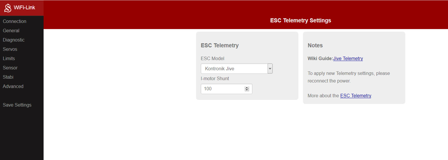

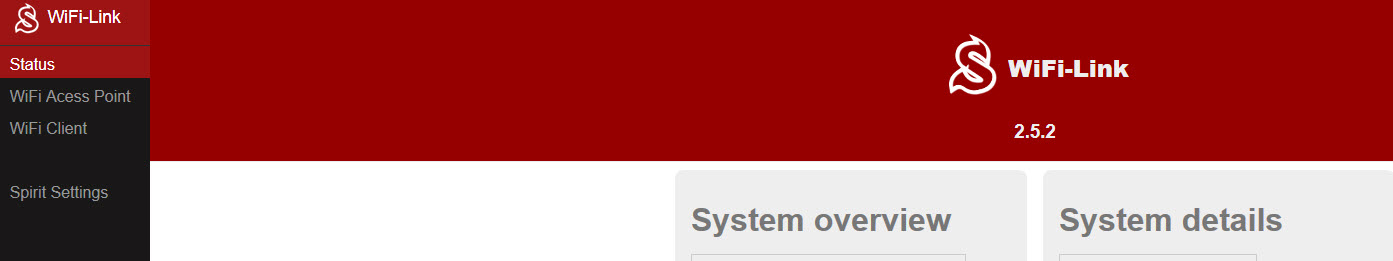

I checked this now and it does not reach the real rpm, it is quite too low.
Also I cannot find the gear settings in the Wlan HTML Interface. I attached two screenshots, as I understood it should be visible there...
