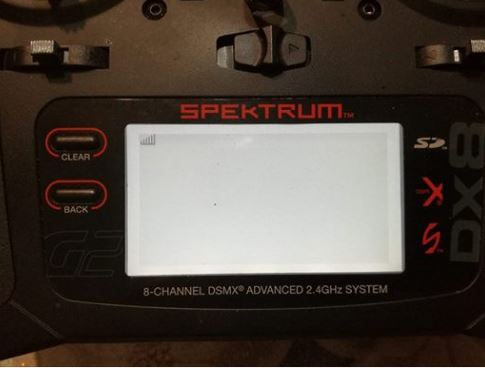

I ask for help if someone can help me to understand why when I get to the white screen of the Dx8 gen2 radio with the latest Airware 2.00 software update, I can not move the rudder to the right and the aileron to the left to enter the menu, but nothing happens.
I state that the connections to the receiver are perfect, and I can bind Radio and receiver SPM4649, I do not have the Jeti cable but I built one myself.
My current configuration is micro spirit,2.4.3 version, hobbywing 40 amp Platinium v ​​4.0, and the latter still have to connect in telemetry. From the radio when I bind, it is done in telemetry mode, and I made sure I entered the Telemetry Text gen section and esc. I am also assured of having a linear curve of gas, but the same I can not enter the menu from pic attached
Thanks all

it was the radio frame rate, you have to set it to 11 ms and not to 22
