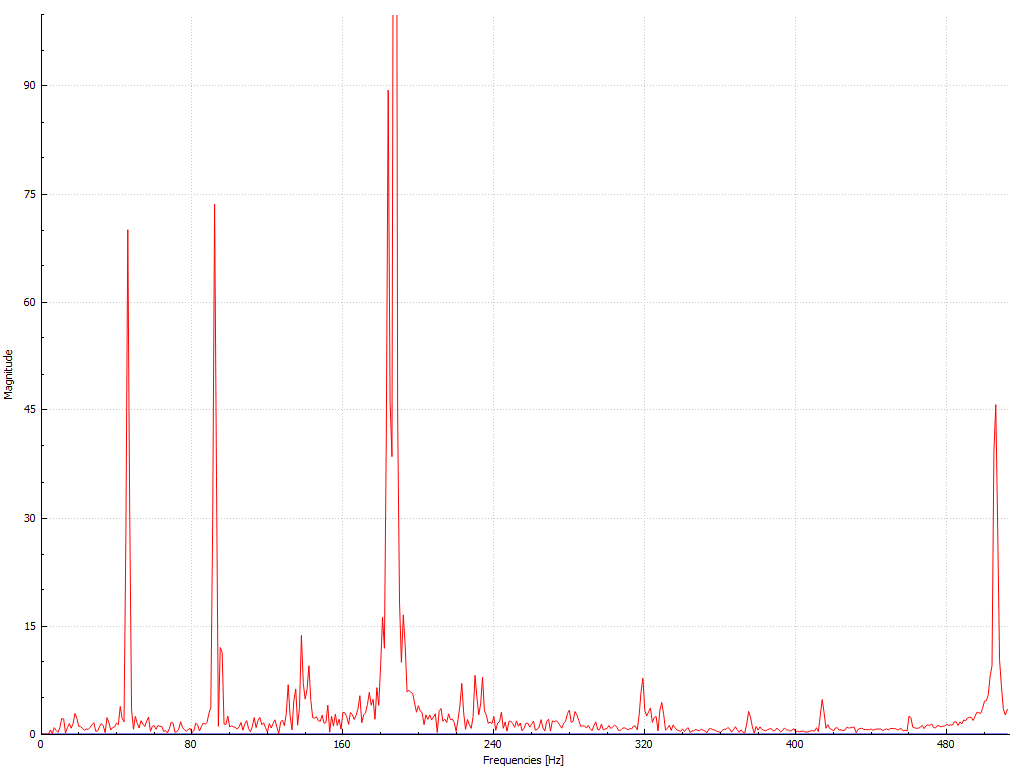

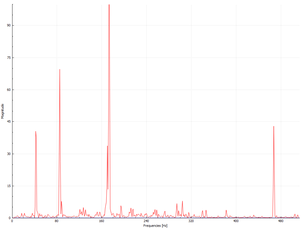

I recently activated the stabilization function on my 450 size heli with the Spirit. When activated, the model would list to the right (right aileron). I appreciates the sticky about imprecise rescue/stabilization- so, I made sure that the mounting was as square as possible and then did a vibration analysis
The yaw, and elevator axes are < 30%. The aileron, as the sticky suggested was way off >80% and sometimes > 100%! The high magnitude vibrations were on the lower part of the spectrum making me think the main blades are the culprits? What else would make these vibrations so extreme on the aileron axis.

I have attached two y-axis files (only way I saw to capture them is [image] with produced a .png format. tell me if there another way to capture all the axes.

PostPosted: Sat 23. Jan 2016 19:52:48
Thank you very much for the plot.
Unfortunately it looks like all rotating parts are not in good condition.
The biggest problem comes from the rudder (or torque tube).
Mostly it is bent tail shaft or not balanced tail blades.
I believe that when you unmount tail blades, it will be much better, than when you unmount blade holders it can be even better, etc.
In this way, you can find what is source of the problem.
Generally rudder vibrations are the worst. But I can see also spikes from main rotor head and also motor.
In case of motor the problem is mostly bearing or too small distance between pinion and main gear.

Multiply the frequency in Hertz by 60 to get the corresponding rpm.
The spike at approximately 45 Hz would correspond with 2700 rpm, which would probably be the headspeed. The spike at approximately 180 Hz would correspond with 10800 rpm, which would probably be the tail rotor speed. The spike at 90 Hz is probably a harmonic of the 45 Hz vibration. The spike at the far right is the motor.
