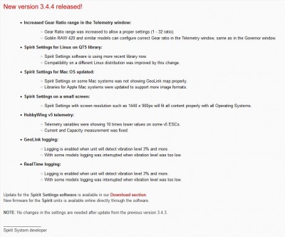

So, I assume this is happening as of version 3.4.4 of the Spirit firmware. Perhaps a bullet point should be added to the description, because when I first read it, there was no mention of this.

PostPosted: Fri 06. Jan 2023 17:30:43
This is not included in 3.4.4, but 3.4.5 that we are working on.
OK, so maybe you should have said that, because the way you said it (we have working F.Port on all Spirit 2, Pro, micro with FrSky integration cable), it sounds like it's working right now, and some people might have already flashed their receivers to F.Port only to find nothing works right now.
PostPosted: Fri 06. Jan 2023 18:09:12
It is working now. For this reason I said that anyone can tell me and we can provide this firmware.

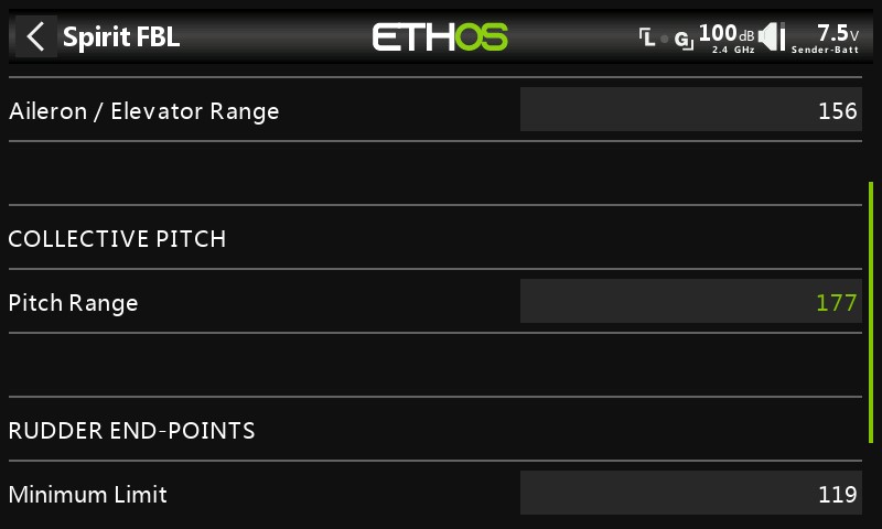

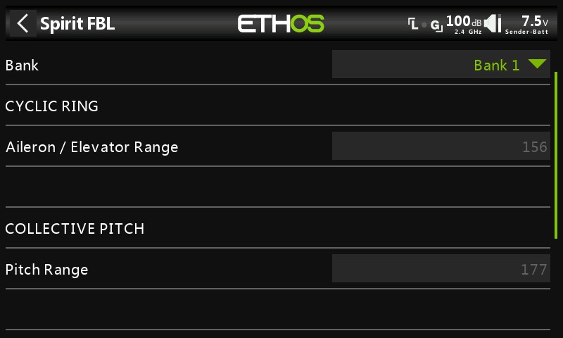

I have tested the LUA Script 3.4.4 with my x20, the integration is now stable, there is no hang up where you had to turn off the transmitter.
But the collective pitch for bank 1 and bank 2 can still not be set.
