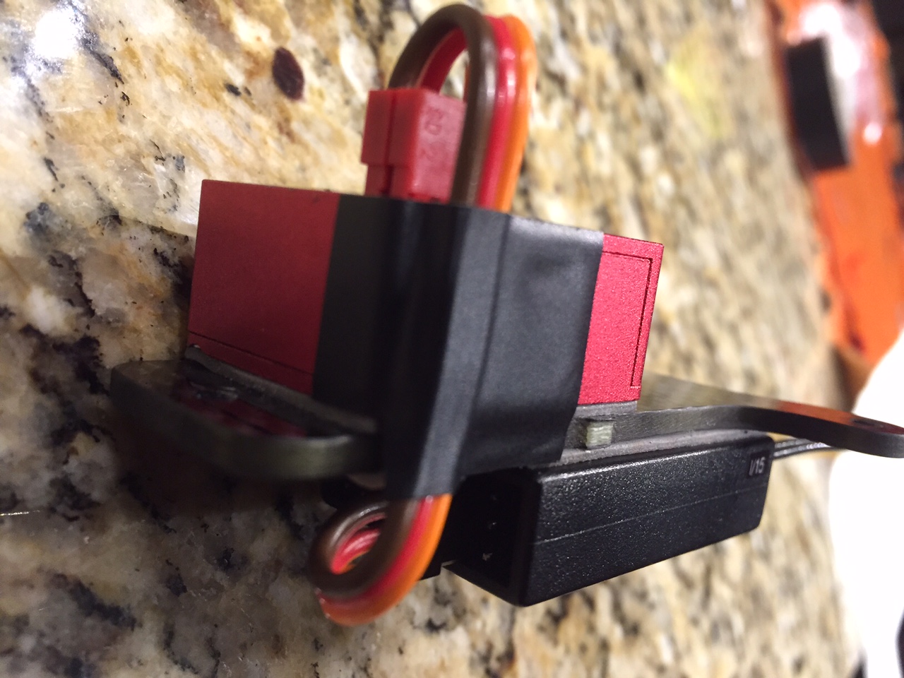

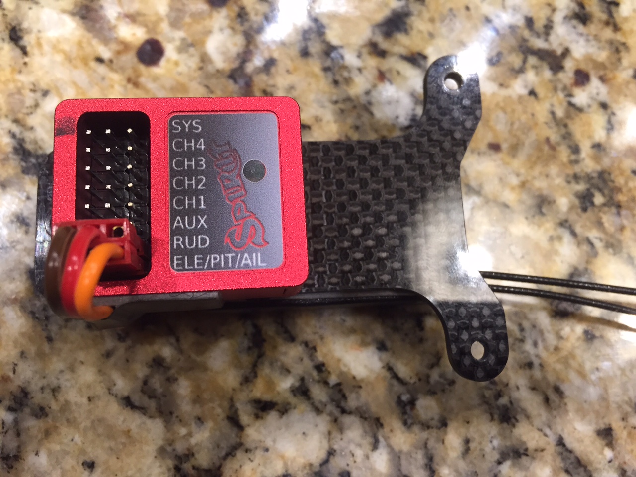

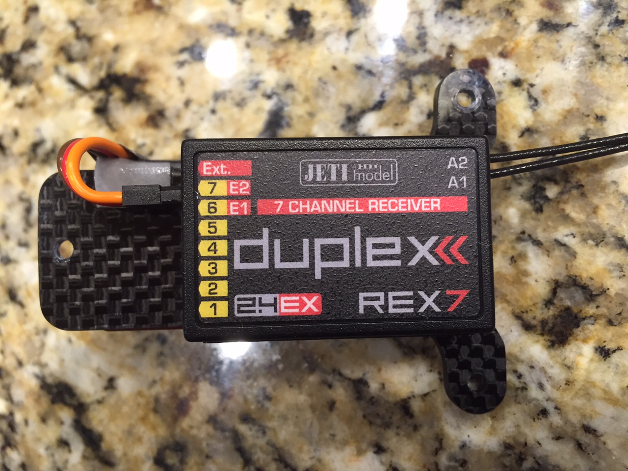

In these pics, you can also see how I used the 3M tape to secure and as a vibration barrier (covered up with black electrical tape) between Spirit and the wire as it is routed along the side. In the first two incidents, I was using the stock Spirit cable that is about 6” long and smaller gauge wire. The latest setup was using high quality wire from a Kontronic BEC lead custom made to be as short as possible (minimize losses and interference possibilities). Also, all servo leads were secured with shoe-goo before flight.
