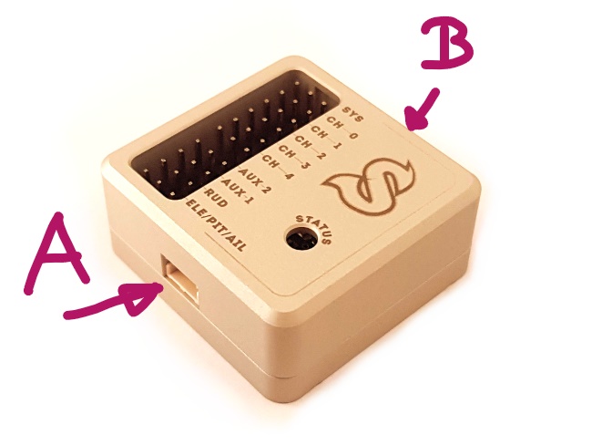

Please see the attached picture of Spirit Pro FC and advice which is the SAT1 and SAT2.
Amal

A is primary and b is secondary...
http://manual.spirit-system.com/index.php?title=Wiring

Thank you.. :D

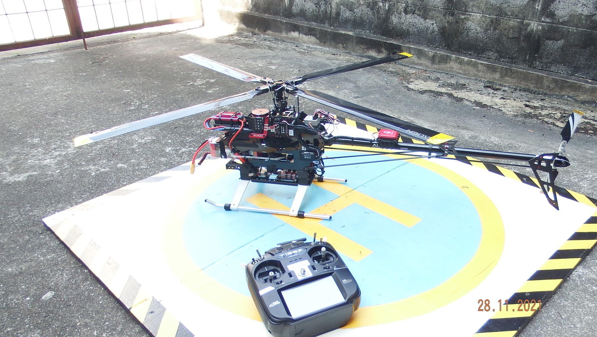

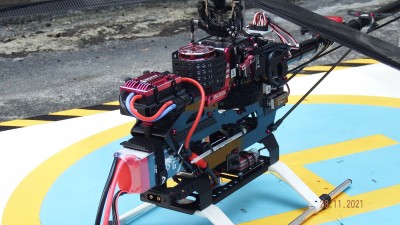

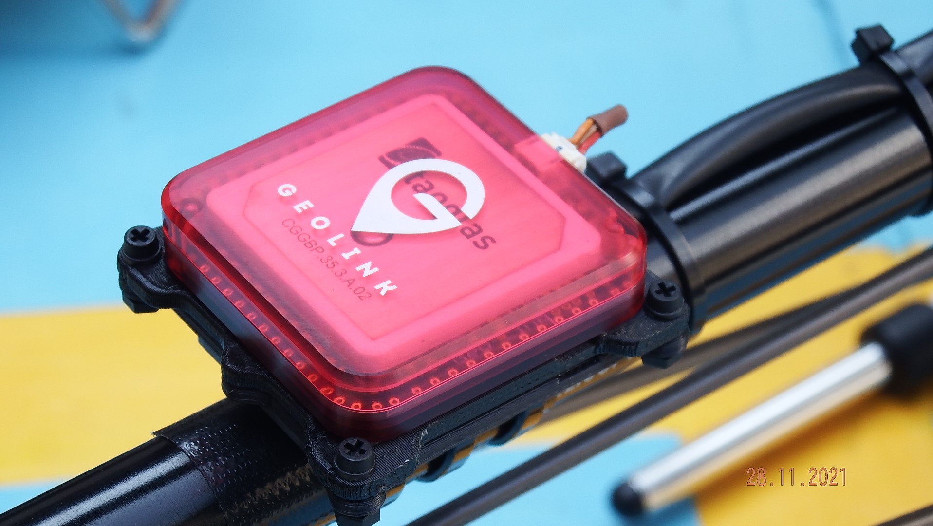

By the way, below are some photos of my bird. Please feel free to comment :D
Amal
