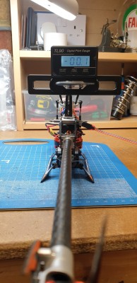

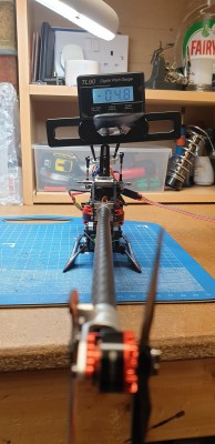

fassla wrote:
can you take a picture how you measure the 6deg ?
As per Manual...."It is necessary to set the value so that the blades angle is at 6° in the aileron axis. You need to rotate your rotor head with blades to be parallel to the longitudinal axis of the mode
Hey buddy.
Sure, I'm checking it the way it is advised to do so and with the way the swash leans over it can only be checked like this.
Ian Contessa
 Post subject: Re: OMP M2 & uSpirit
PostPosted: Sun 30. Aug 2020 19:11:36
Joined: Mon 24. Aug 2020 14:52:35
Posts: 23
Please spoolup tge motor without blades to see if there is any strange behavior.
If no then it is just Geometry 6°.
Evening mate.
I have done this already even when I had the higher than expected geometry setting and there has been no apparent issues or problems noted at the blade grips or swash plate.
I am assuming you're thinking of vibration maybe or increased electrical noise bugging the FBL.
Ian Contessa
