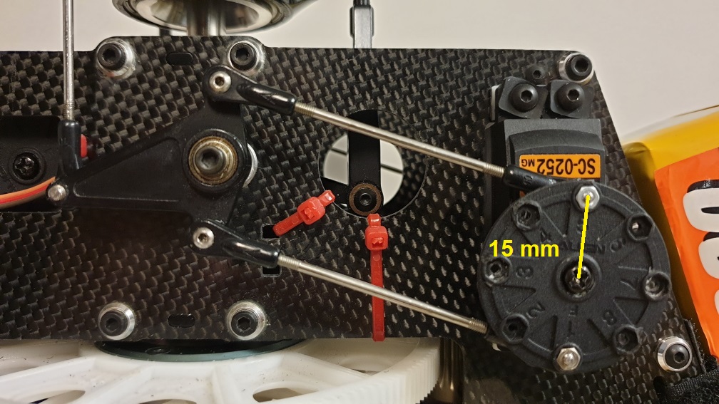

regarding your geometry.... if i remember correctly it is a Align 600 DFC you are using? what is the length of servo horn you are using? i do remember well, when converting my 550DFC to vbar, i had to use shorter horns... or else geometry would never be near the "green" zone... maybe it is the same here? stock Align horns are somewhat on the longer side if i am not completely wrong?

pls measure the length of the servo horns... this could help to have an idea. iirc the lenght for the Align 600 FB head was ~21mm and it was ~18mm for FBL head... so your 600 DFC should be fine with horns around 17-18mm if the swash is standard (or at least using standard geometry). i remember that the DFC swash was even a little sharper on mine.

HeliMLM wrote:
not the links - the servo horns :) they are possibly the problem!
Do you mean this?
These are the original Align servo links
