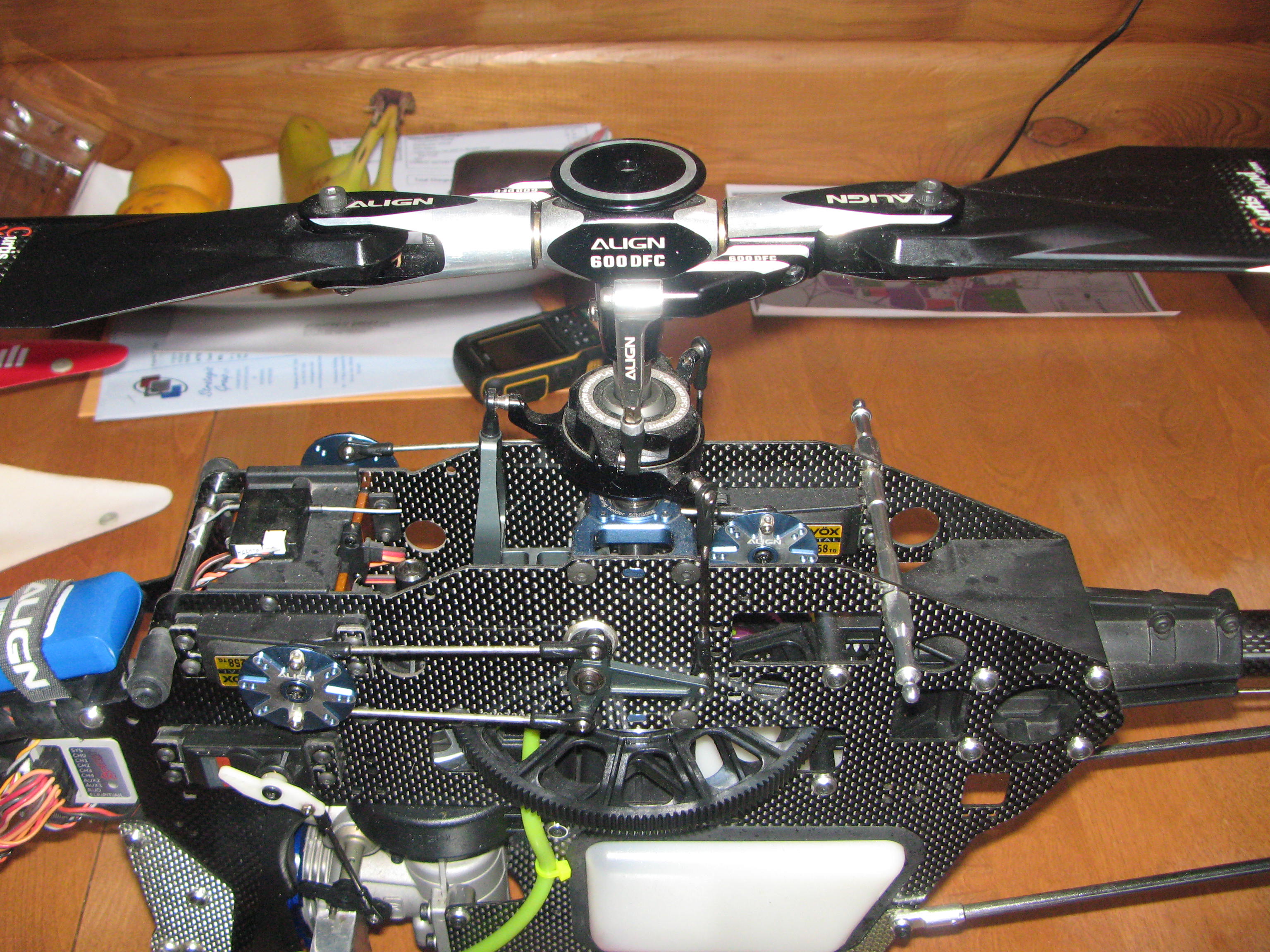

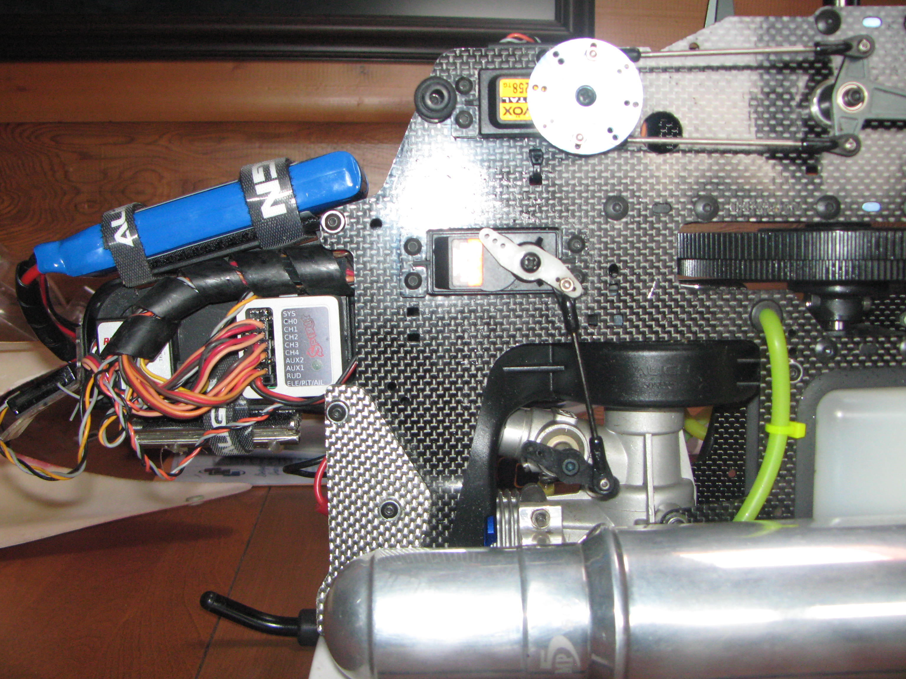

Here are the pics,

Thank you for the photos!
Correct position is: Vertical (180° - left side).
There is very important difference between CCPM 120° and CCPM 120° (reversed). Servos that are for aileron/pitch are swapped.
You can see it in detail in the Setup Wizard, but it is also visible in the General tab.
CH3 is left servo, CH1 is right servo. With non-reversed option it is in the opposite way so if you connect it in the opposite way, it can't work.
