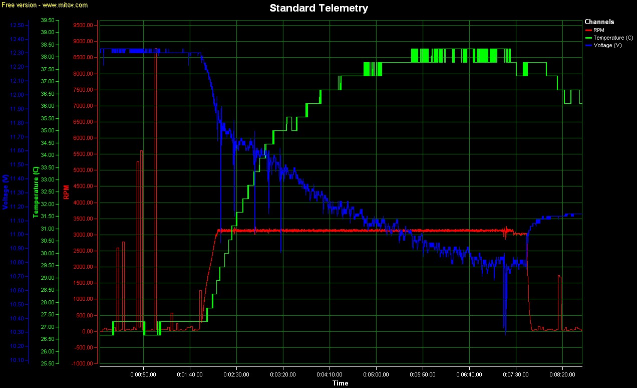

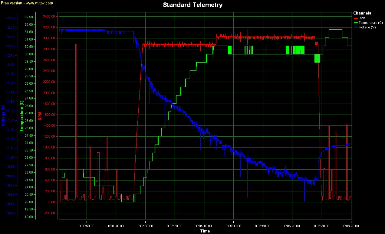

I've attached 2 logs from the Trex 450L with more aggressive flying - pitch pumps, inverted punch outs, rescue used a few times (hence aggressive correction and pitch) and the usual flips/rolls. Probably not even close to your flying style but its the most aggressive telemetry I could find :) Hope it helps you!
This one is with 3S setup and 326 Rail blades - you can see the gov holding well despite the sharp voltage drops / spikes
This one with 3S setup and 360 Align blades - here you can see the switch between flight modes and the gov holding pretty well despite the longer blades and 3S setup

Actually there are some 300 rpm dips but you can tweak the gov some more I think.

Yeah I hadn't changed the gearing for the 360 blades and was running too high a pinion for the setup. Also had done no tuning with these blades - only with the 326 rail ones. Didn't like the 1m reduction in flight time so off the went :) This one is far more under powered than the Goblin 500 and I had to up the governor response by 2 points higher than the goblin. That made it hold better but still there are higher fluctuations than the goblin, probably due to voltage sag and low power motor (the align 460mx 3200 KV)
