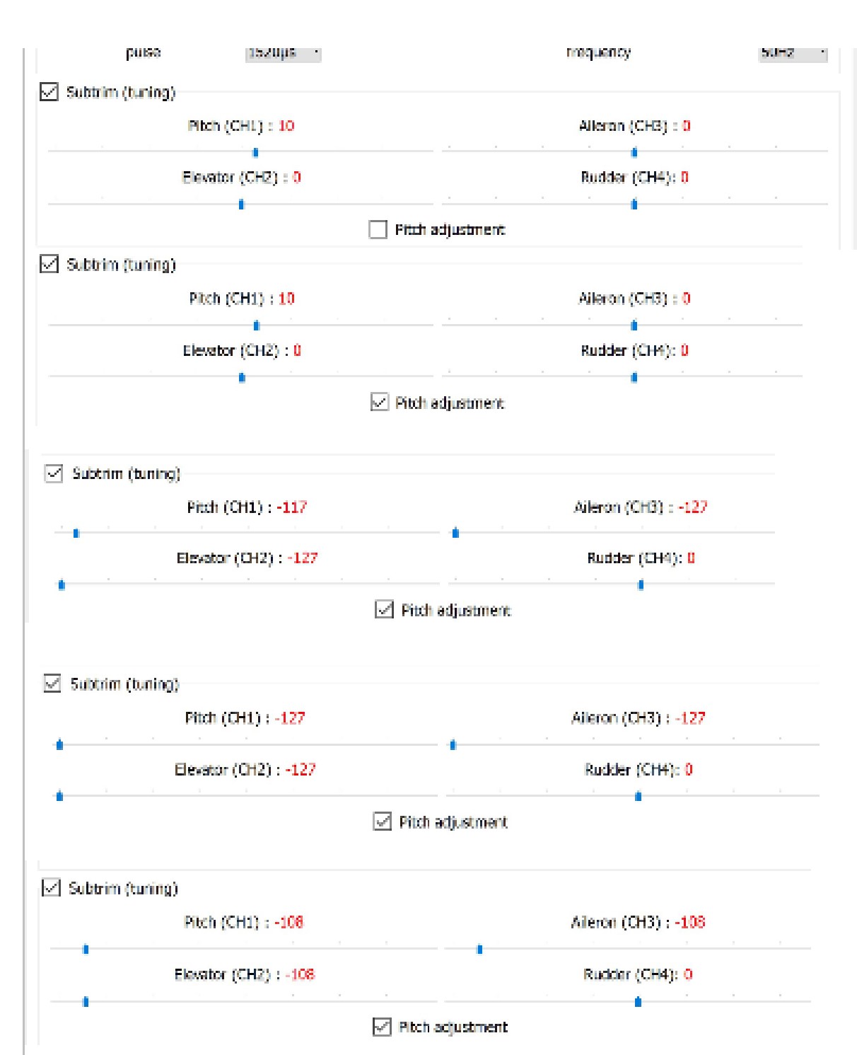

the problem is also in Demomode ! If you put one Slider to +10 and then set pitchadjustment and move the controller positive, then the difference always remains the same, but if you move the controller to the left everything is initially ok until the two adjusted controllers are at -127, after which the adjusted controller can also be pulled to -127, i.e the difference to the other controllers is then suddenly "0"! If you then set the direction positive again, the difference remains "0", which then doesn't change anymore...there is something wrong -
initial situation:
