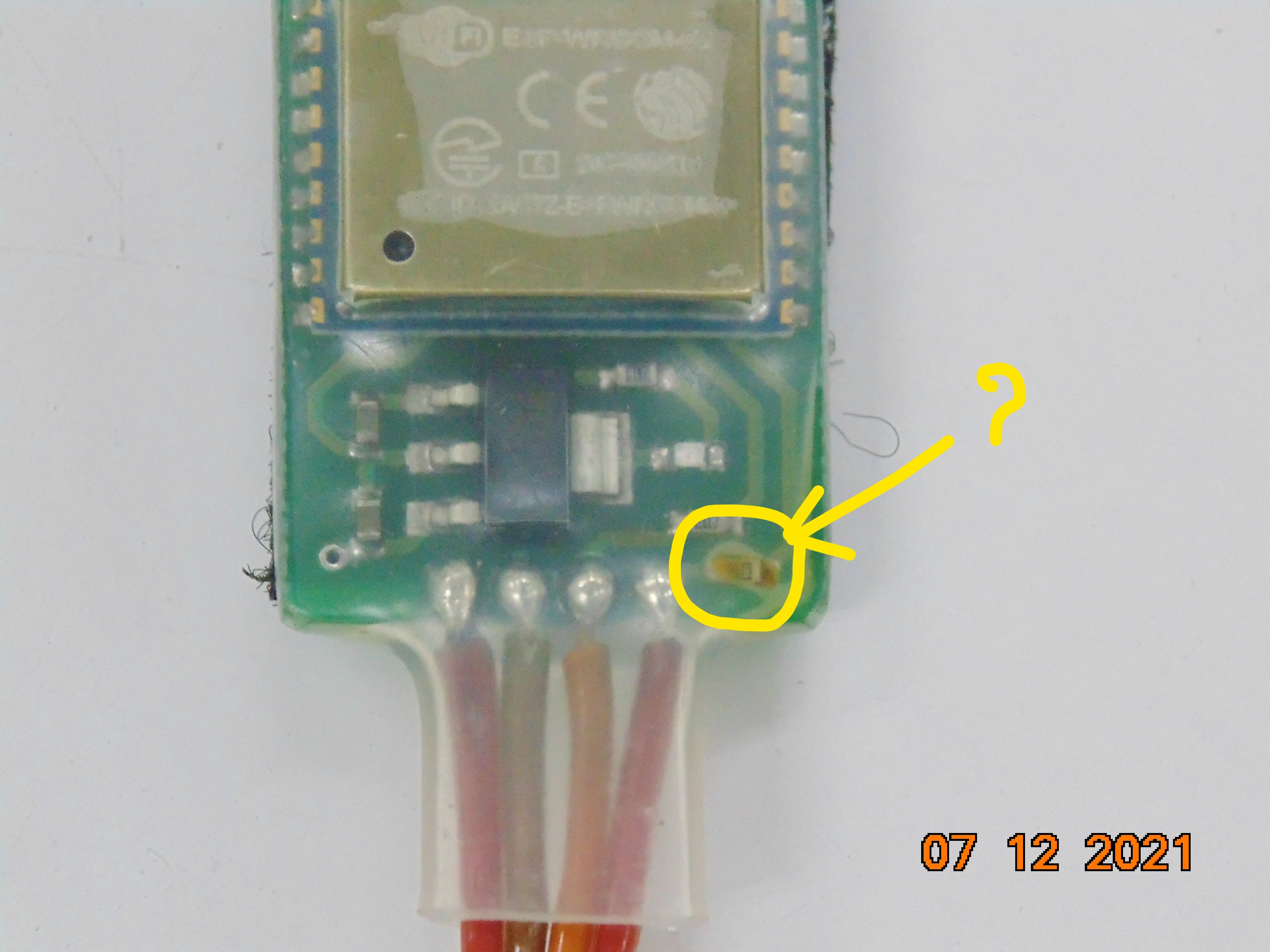

Forgive me for repeating the same question. Please confirm the subject resistor is the one on the lower right side corner on the RX circuit.
If not, please point out.
Tonight I shall place the order for a fresh unit. I am not sure it will reach me before Christams holidays start. Anyway, I shall give a try to repair this till it arrives.

Yes, you are right. This is the resistor.
If you will select Express shipping, then it will arrive to you within 1-3 business days.

Thanks for the confirmation. The 0603 code came up with multiple brands and resistor tolerance 1% to 5% and 0.25W, 0.1W and 0.2W. What is the most suitable?

All will work, but 1% and the highest W is better.

If I was you, I will replace both TX and RX resistors ;-)

Mr.Urgno,
In that case I have to disturb Mr.Tomas again to find out the resistor specs of TX ! :D
Anyway, I am planning to order a new unit. The repair is just for my learning. 0603 Resistor is quite small and need to buy in bulk.
Amal
PostPosted: Tue 07. Dec 2021 11:32:35
they are both 100ohm ;)
> Spirit 2 issue can be resolved by replacing 2 resistors with 0 - 100 Ohms. So if you do not have any, just do a short.
