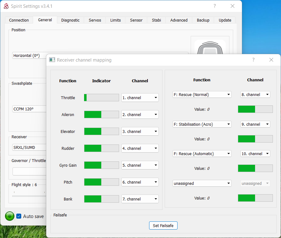

Hi, with version 3.4.1 it became much simpler to setup various rescue modes, including auto rescue.
Before that, I never managed to get my most important requirement to work that is for manual rescue to always work, regardless of the current rescue mode and without having to misuse bank switching.
With 3.4.1 I now have a channel assiged to each mode I use:
1) manual rescue via momentary switch
2) auto level via position 2 of a 3-way switch
3) automatic rescue via position 3 of the same 3-way switch (when this 3-way switch is in position 1, auto level and automatic rescue are disabled.
Manual rescue is now always possible and has priority which is what was needed.
One note: I'm using Spirit GT and not the GTR as I do not have Jeti.
Bernd
PostPosted: Tue 09. Aug 2022 23:28:15
Joined: Tue 09. Aug 2022 15:50:53
Posts: 55
Hey Spaceman.
Good one. I will give it shot.. Thanks for sharing.
PostPosted: Wed 10. Aug 2022 10:11:26
Joined: Sat 31. Jul 2021 12:45:51
Posts: 37
Hi Vector,

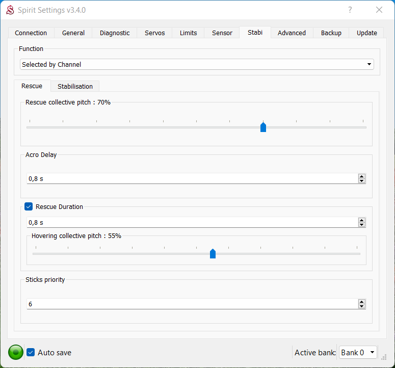

In the General tab / Channel assign the desired rescue functions - see my example attached.
In the Stabi tab you need to select "Selected by Channel" for all rescue modes you want to configure.
No need to assign "F:Stabi Function" anymore with this setup.
Please note: when "Selected by Channel" is selected, you may not be able to reach all parameters e.g. the parameter that lets you configure the inverted flying compensation offset for the automatic rescue mode.
In this case, temporarily select that mode and make you desired setting and then do not forget to switch back to "Selected by Channel". I'm hoping that Tomas reads this as well and it gets fixed in a future update.
If you have been using bank switching in order to use differnet rescue modes so far, I recommend to check for any remainders of that by using the Bank Comparison function located in the Backup tab - this is the button with the two arrows <-->
By the way, the autoleve acro mode is great for practicing inverted maneuvers e.g. inverted hover, inverted pirouetts and even piro flips. Now that Manual Rescue always has priority it is fairly safe to use. Before 3.4.1 manual rescue would not work while in another rescue mode unless you jump throogh hoops trying to accomplish this with mixers and/or virtual switches on the transmitter - big improvement towards safety.
Hope this helps - I wish the user manual would improve in this regard.
Cheers and good luck, Bernd
