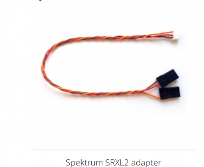

Perhaps one more note, did you use the correct SRXL2 cable? See the picture in the appendix -
greeting
Matthias

Incidentally, that is the very same cable I use with the 4651T.
-Eric
