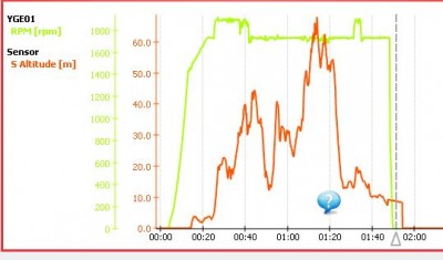

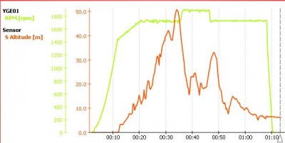

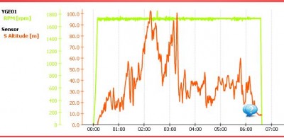

Hi Spirit Team
I have done some Telemetry screenshots to show you the behaviour in different flights.
Everytime after landing the "zero height" was 6 -10m. See screenshots.
"height-diff2" Shows that the automatic rescue alititude was set to 20m.
About 30 sec after take-off i tried it out and the diagram shows it very cool ;-)
BR
Philip
PostPosted: Mon 12. Jul 2021 7:43:27
when main rotor is spinning it creates very big pressure difference under the blades. This is causing "drift". Unfortunately this is very dependent on where the unit is located. Generally
it should be more or less similar each time so it shouldn't be a problem.
PostPosted: Mon 12. Jul 2021 10:15:31
Joined: Fri 09. Jul 2021 8:12:20
Posts: 12
Most of the flights show 8-10m of difference after Landing.
Does this mean that my solution setting the rescue height to a value of 20m to get a "real life value" of 10m is the correct way to go?
BR
Philip
PostPosted: Mon 12. Jul 2021 10:48:29
Yes, this should be OK.
