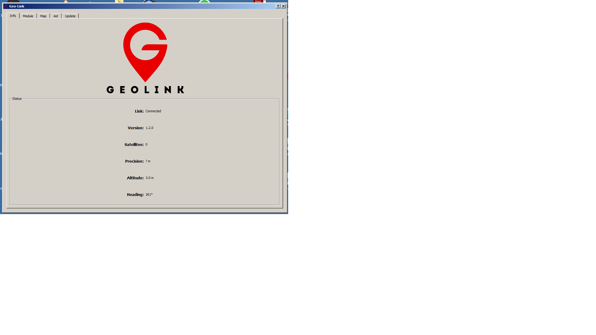

ah, this seems to be wrong.
Blue light must always turn off after power up. This mean that GeoLink module is not working properly.
Are you sure you were not flashing GeoLink firmware? Or there wasnt any attempt? It could be enough just to flash it again in recovery mode. Then it should work well again.
Yes, I didn't remenber, after flashing 3.2.0. i tried to update the geolink unit and get stuck at 3%....... :oops:
I have done a recovery (unplug the GeoLink cable and plug it back immediately...) and everything works correctly.
Thanks a lot ! :D :D
Jorge
Spain
PostPosted: Tue 20. Oct 2020 17:17:22
Perfect. So the only problem was GeoLink flashing. I believe all will be OK now.
