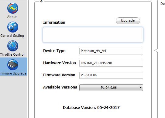

Looking at the German Forum (I'm Swiss) they think it's a Hardware issue with HW160A also based on JLog experience.
Lets compare:
On Spirit I'm running FW 2.4.1
I have HW 160A HV
Hardware Version: HW160_V1.00456NB
SW: PL-04.0.06
Not that this Hardware Version numbers means anything to me but we might be able to compare and we find a pattern.
Beside, you mentioned my proposal with Data wire only is not working.
Do you mean not working at all or does it not give better results?
regards, Adrian

Looks quite identical.
Your proposal gave exactly the same result as the Y Cable, so current much to low all the time.
