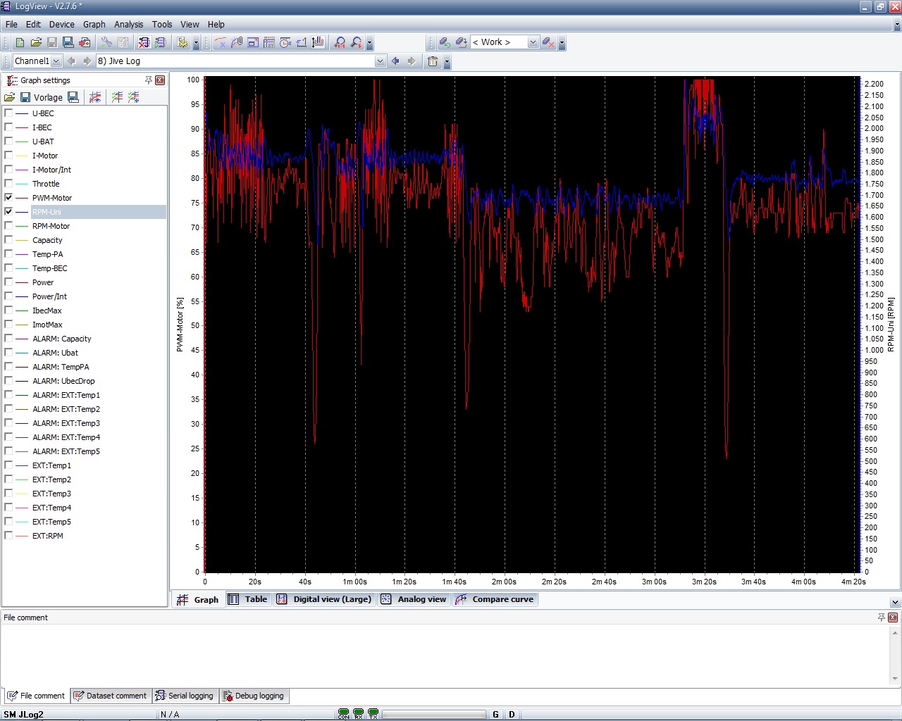

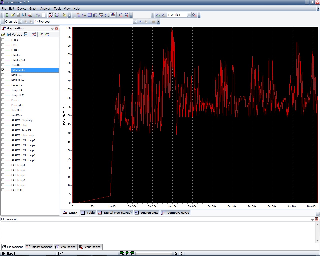

endpoints and gearing is spot on, this is with 1650 and and 1850 rpm.

Can you post Throttle plot, please? Your governor settings are looking really weird.
We will see if throttle is reaching the max. limit.
It looks like there is really some problem, you can try to decrease RPM Sensor Filter - lower is better.
Changing Throttle Frequency can affect the response significantly as well.
It looks like there is some delay in the response, which is unwanted for external governor. Changing these two parameters can help a lot.

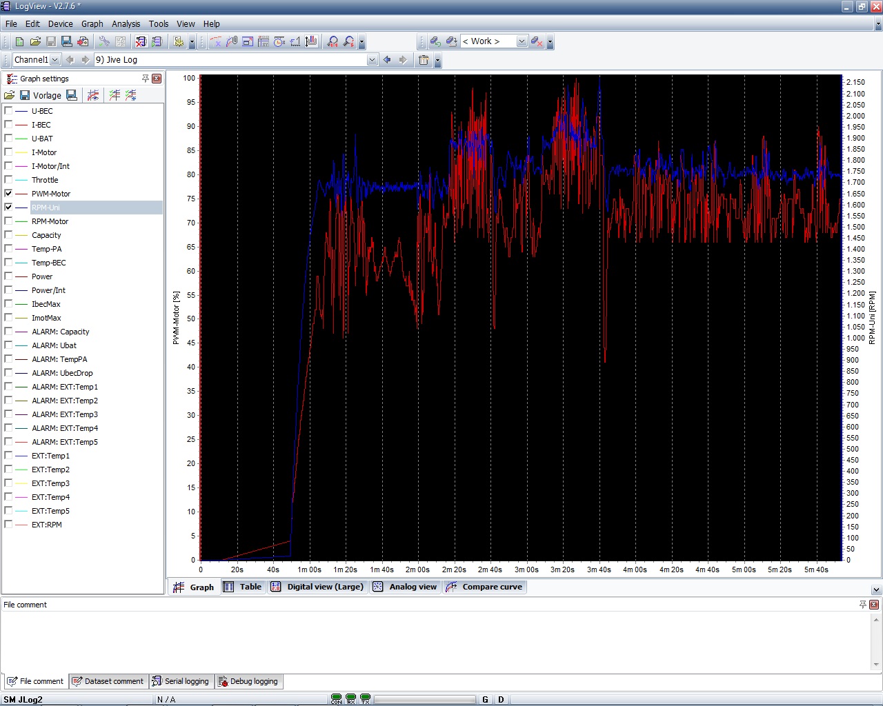

Here are the logs, same behaviour as on the bench, I start with 1650, then go to 1850, if I go back to 1650 its 1740, thats not normal, Also you see extreme pwm dips, at those points rpm drops a lot, it happens when changing idles.
Its not holding that great. ESC is on plane mode. No other thing I can change on the esc.
rpm filter at 4 now. And 200khz.
