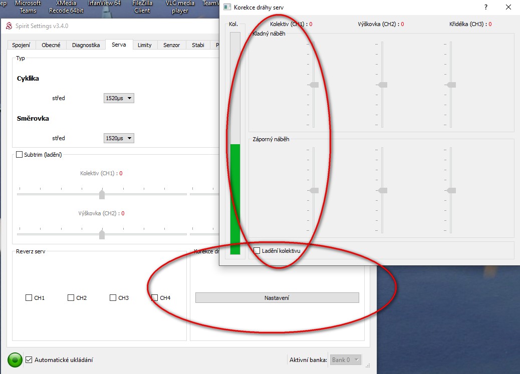

Hi, why it's not possible to adjust the negative Pitch with the Setup Wizard or the software at all !?? :cry:

Go into servo tab, then servo travel correction at the bottom right hand side...

Because you set the range and it is the same for + i - ... and if you want to fine-tune it using a bookmark Servos (picture) or in the transmitter using a collective curve :-D

PostPosted: Fri 03. Jun 2022 9:00:38
If you need to set positive and negative pitch separately then in the most cases it mean that your mechanical center was not configured correctly.
For this reason positive and negative pitch does not match. There are some models that have asymetric travel due to wrong servo placement or servo arm lengths, so it might be required at these models. Also some servos are not moving equally even when they are same.
For these cases there is Servo travel correction.
