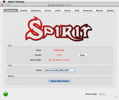

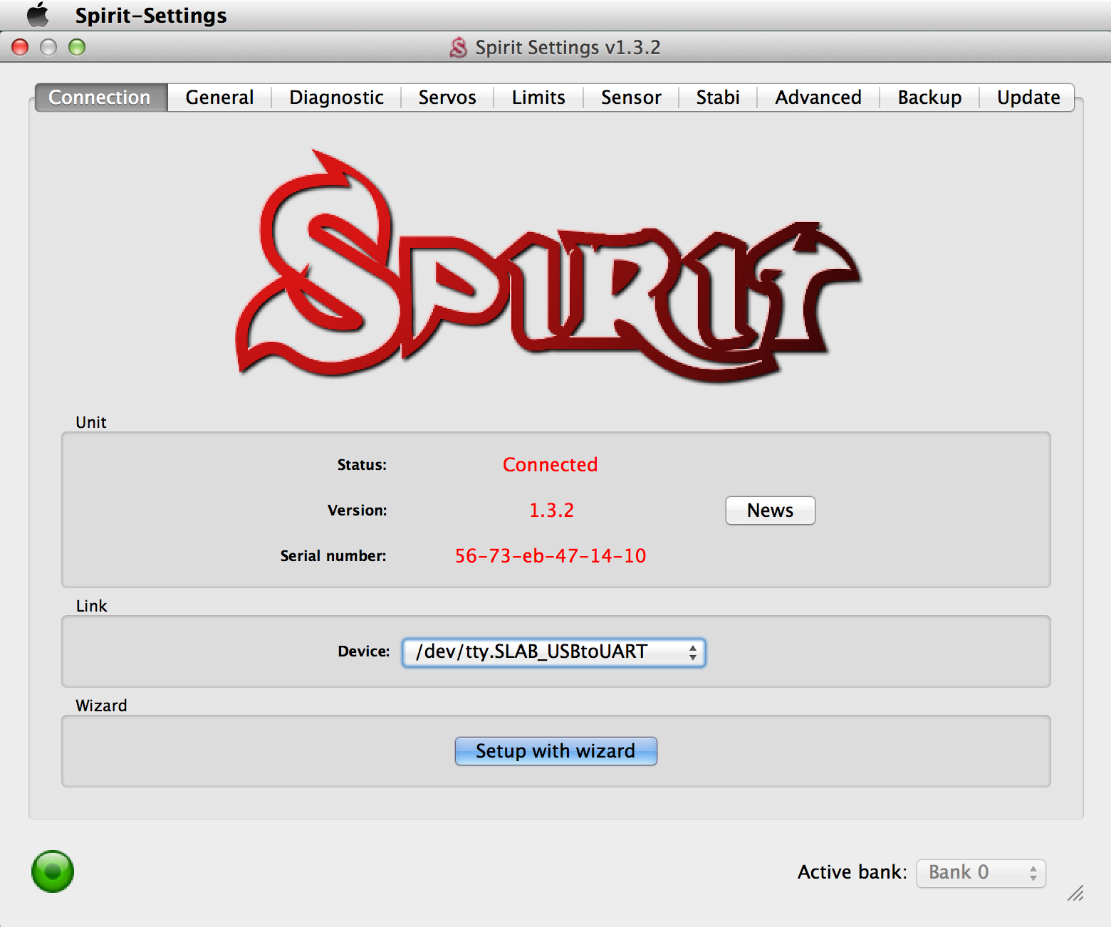

MacOS 10.9.5 / USB connection works / Spirit Software shows connection and the device serial number

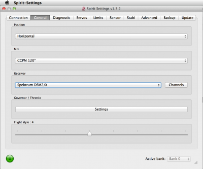

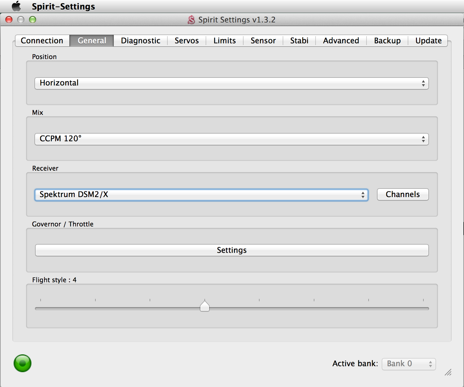

is the Receiver type parameter configured to Spektrum DSM2/X? If no, then binding will not work.
After changing any settings it is necessary to save it to the unit else it is lost after power is disconnected.

yes, in the "general" tab is the option "Spektrum" - and also saved on the device.
This was the step 1 in the wizard and worked fine.
But after that - no flashing lights on the satellites - some restarts and reconnects later - no flashing lights on the satellites.

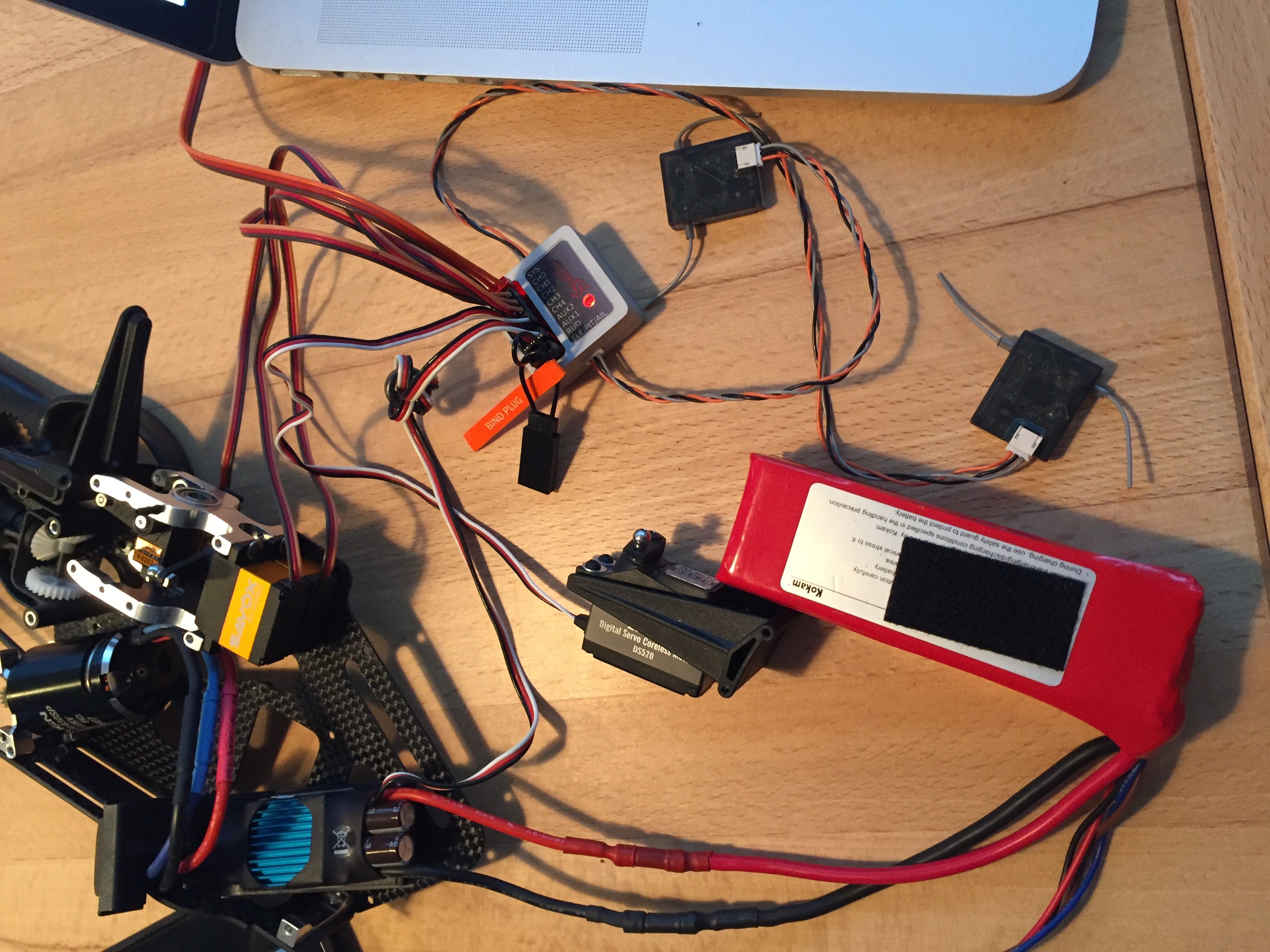

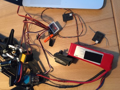

the power is on AUX1
I tried
- Power AUX1, BIND plug in ELE/PIT/AIL without servos
- Power AUX1, BIND plug in ELE/PIT/AIL with servos
All with or without SYS connection tested.
See picture enclosed.
Any tipps?

See also the screenshots of the settings
