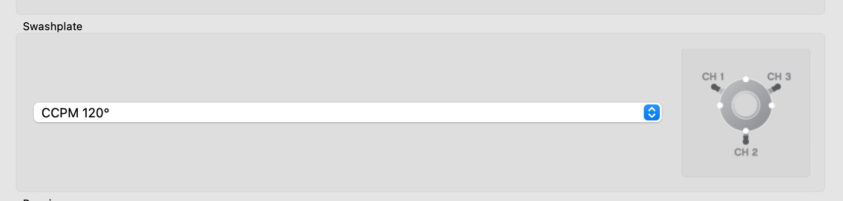

Hi, I’m trying to set up an Align TB60 with a spirit 2 FBL. The Swashplate set up options don’t have the TB60 servo / channel configuration. I’ve tried going through the other options but nothing is working. I’m starting to pull my hair out with this so any help would be much appreciated. This is my first FBL so highly likely ITs me getting it wrong. I’ve attached some photos for reference.

hello
disregard the channel numbering of align manual
just follow the channel numbering of spirit software
