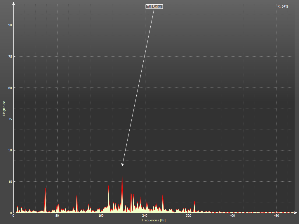

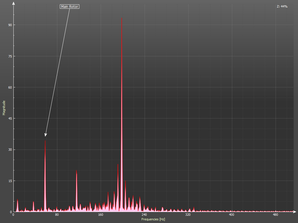

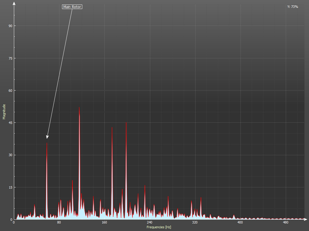

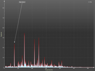

taller51169
Posted: Sat 03. Feb 2024 12:07:19 |
Joined: Fri 05. Jan 2024 16:22:18 Posts: 8
Top |
Posted: Sun 04. Feb 2024 17:26:21 |
Site Admin |
Joined: Mon 29. Apr 2013 16:06:44 Posts: 12272
thank you for the plots. Are they measured with tail blades on? If so, the vibration level is not that big, but there is clear resonance near the tail visible. It could be enough to readjust belt tension or check if there is not a play at the tail shaft. Make sure all bolts are tights near the tail.
