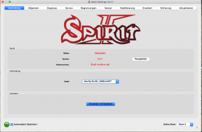

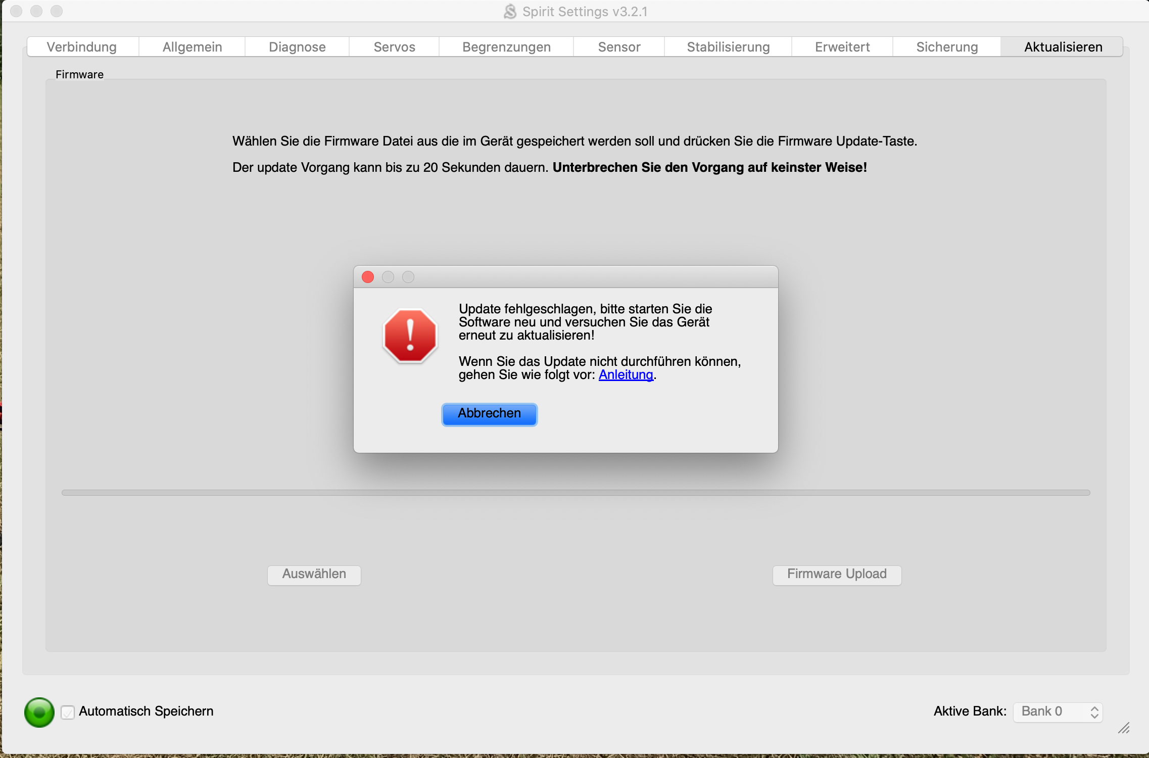

Hi Tomas,
yes, of course Settings 3.2.1 is in use (and all units are on 3.2/3.2.1 before)... on both macOS and Win. i've just done again and documented with screenshots for you.
best regards
File comment: 2. macOS, 3.2.1 upload failed
File comment: 1. macOS connected, Settings 3.2.1, unit 3.2.1

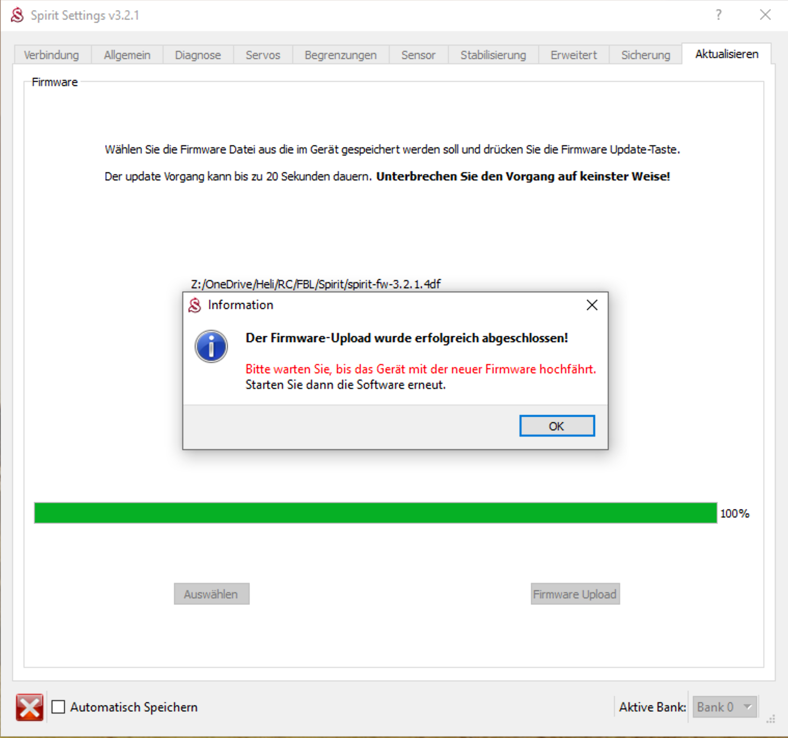

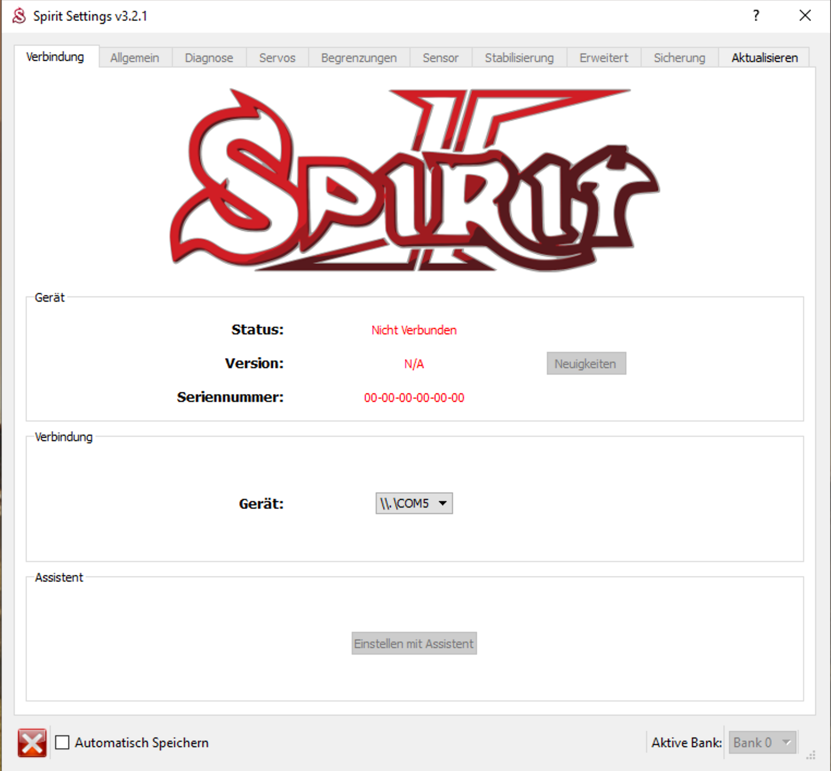

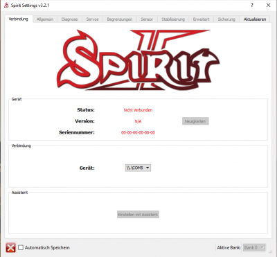

PostPosted: Fri 27. Nov 2020 9:44:07
.... Win success screenshots.
File comment: 4. Win recovery 3.2.1 success
File comment: 3. Win recovery mode
PostPosted: Fri 27. Nov 2020 9:45:51
You can try to download the latest USB drivers for Mac.
https://www.silabs.com/documents/public ... Driver.zip
Then after reboot retry.
So the software is waiting after clicking the Flash button? And then after few seconds you can see error, is this correct?

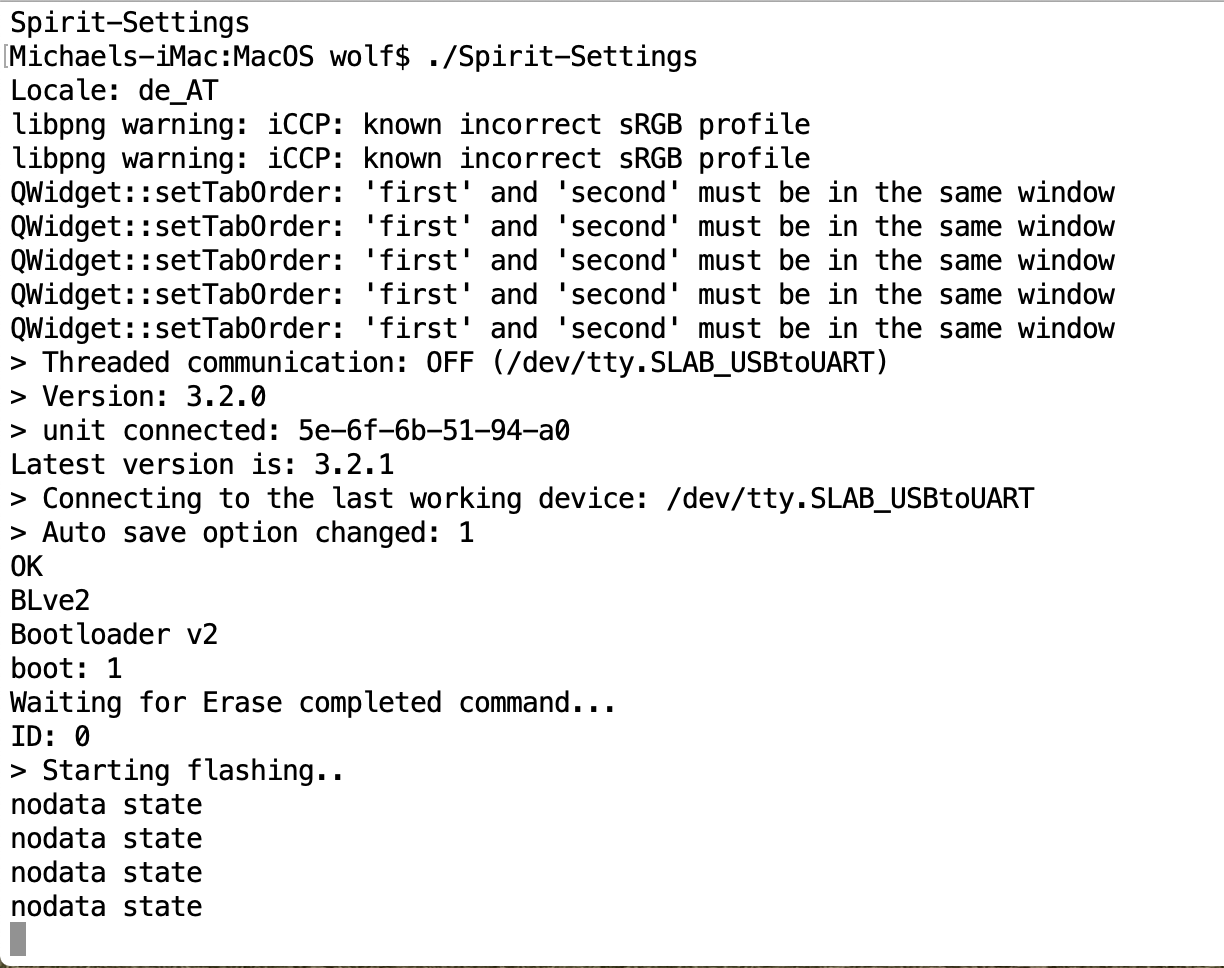

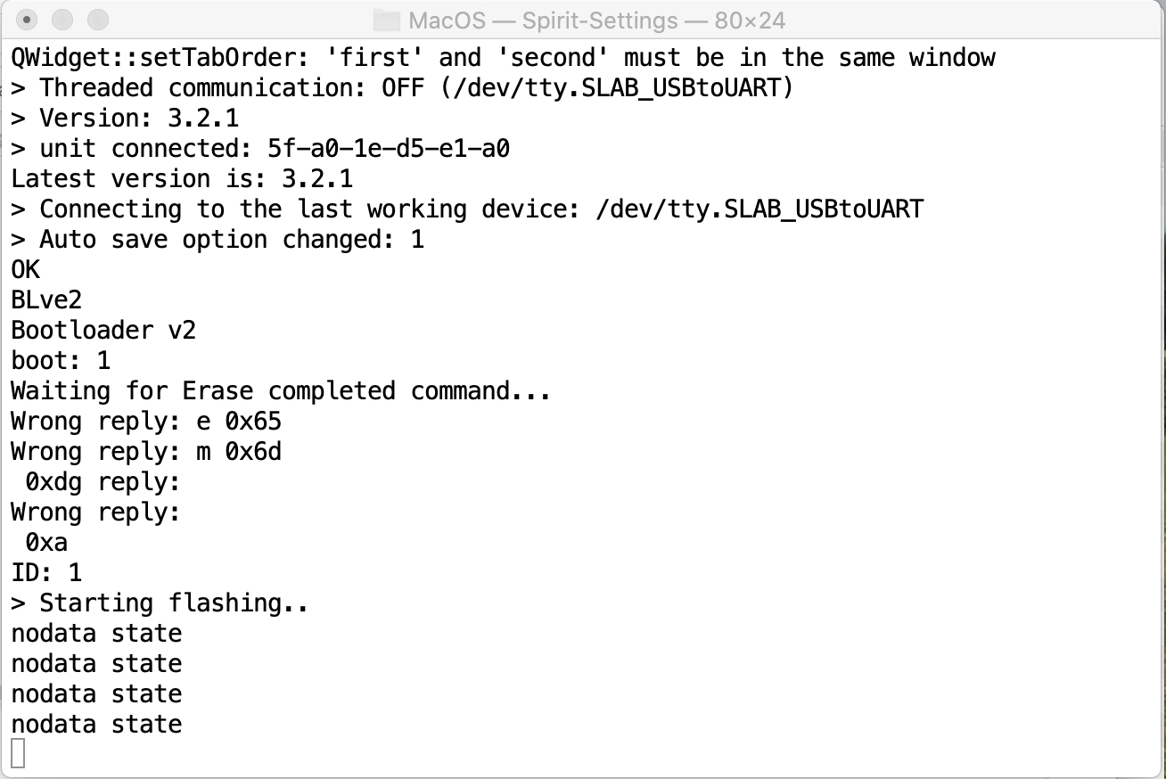

PostPosted: Fri 27. Nov 2020 10:24:48
Thank you. Are you able to start the Spirit Settings in terminal on Mac?
You have to enter the .app directory and then start the "settings" with ./settings
This should give us error and reason why it is failing. Is this happening with all units?
Here we have Mac with 10.13 and 11.0 and both are flashing well.
PostPosted: Fri 27. Nov 2020 10:38:17
... ok, this is Terminal output (added result from a 2nd unit (v3.2) w/ different programming cable).
