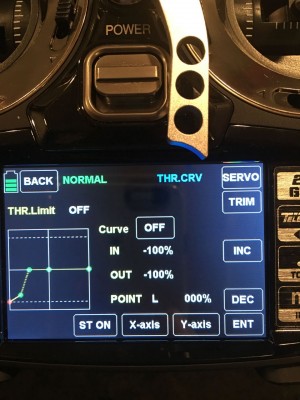

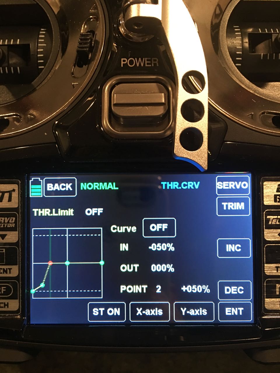

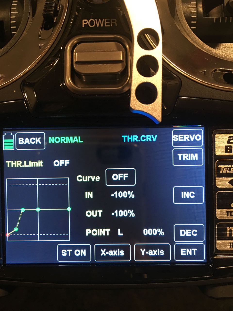

Thank you for the reply. Just some clarification on point 5. I would typically use some trim on the throttle to get a good idle are you recommending that no trim be used and have a curve such as 0-10-50-50? I have attached some screen shots from my radio.

Yes, you can use a trim for the throttle (especially for idling). But if you would set TC to somewhere near 50% it will reach at least 50% of the motor RPM which is quite high.
So a flat throttle curve near 10 - 12% + a trim should be better.
